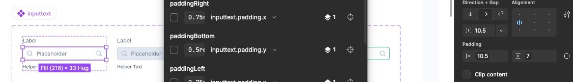

The library has a component called inputtext uses padding variables set to 10.5 horizontally and 7 vertically. I can see these variables both in the properties panel in Figma and in the Token Studio for Figma plugin. (Note that I don’t know much about this plugin and I try to use it because PrimeNG suggests it for using their system and my client’s dev team is trying to leverage it.)
Padding settings in for the inputtext component (Figma and Token Studio)

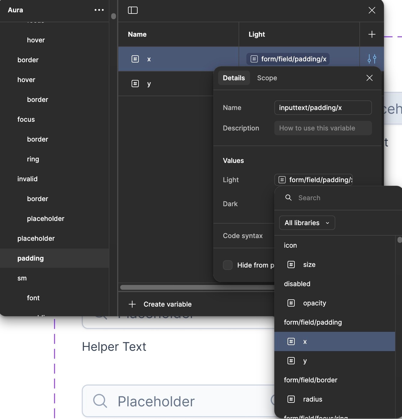

Padding variables in the Variables window in Figma
But I can’t seem to find how to edit these values. For instance, when I click into the vertical padding value in Figma’s properties panel, it shows me the list of variables and their values. But hovering over that particular inputtext/padding/x variable doesn’t show an affordance I could use to edit the value, from 7 to 8 for example.
Same when I pull up the Local variables window in Figma. (Side note here: isn’t there a way to search variables by name there? I find it hard to locate a specific variables just by scrolling through the list, but I’m not seeing a search feature.)

Hi, I am currently working with Figma's variables tools for a design system and I fell into your post because I am also having issues working with them. However, I have found some tools that have helped along the way. Figma does not have a search tool in its variables window. I have used some plugins for searching. Design Lint, Find Missing Variables, Style Finder (for when styles have variables applied in their params), Styles & Variables Organizer, Variables Inspector (there are two plugins with the same name one has more features than the other), Variables Lint, VariableScout, Variable Vision, Variable Visualizer. Hope those help.
From my limited knowledge of working with these tools so far the answer to your question about changing a variable's value is that you are not supposed to do that so the is no way available for doing that. The only way to do that is by going to the source file where the variable was created, opening the variables window and changing the specific values associated with the variable.
