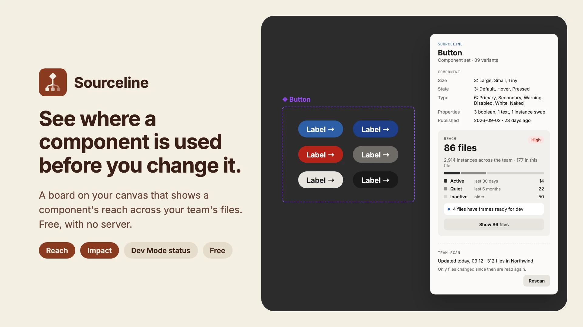

Diogo_Figueiredo
Sep 30, 2026 8:49 PM UTC
I built a free widget for this, Sourceline. Place it next to a main component in your library file, and it shows how many team files and instances use it, which of those files are active, and an impact badge, so you can judge a change before you make it. It reads files through the REST API with your own read-only token. https://www.figma.com/community/widget/1686375993972598287/sourceline
