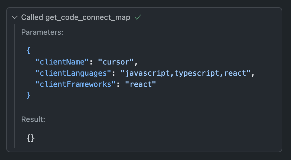

Problem:
I have Figma Code Connect set up and working in my project (I can see other components like TextField from @pperform/atum are properly connected), but when I query the code connect mapping for a specific Figma component, I get an empty result {}. I’m sure that i already get the right component which have the setting code connect.
Setup:
  • Figma Code Connect is configured and working for other components in the project
  • Using React/TypeScript frontend with @pperform/atum design system
  • Can see "Connected" status in Figma for other components (e.g., TextField).
Expected Behavior:
Should return the code mapping/connection details for the Figma component
Tom Reem
Tom ReemSolution
Jul 17, 2025 5:10 PM UTC
Hey ​@PP_FE and ​@Sergey Chuvayev — welcome to Figma Forum, and thanks for raising this!
Good news: I just confirmed with our engineering team that this query now works with both instances and components. When this was first reported in the original post above, it only worked on instances.
When you have a chance, give it a try and let us know how it goes. In the meantime, don’t hesitate to reach out if anything else comes up — we’re always improving based on your feedback.💡
