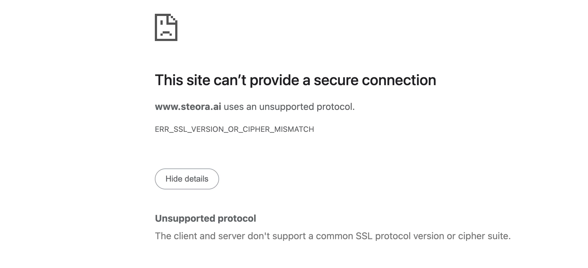

DNS CNAME record is not getting verified. This issue is really urgent. Any help would be appreciated.

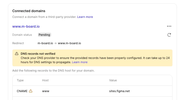

We're experiencing the same issue with DNS CNAME record verification. It’s also critical for us, so we’d really appreciate any support or updates on this as soon as possible. Thanks in advance!

​@Rajshree Agarwal — firstly, I went to steora.ai and it appears to be up (🎉) — can you confirm that it is showing up as expected now as well? If not, we’ll keep digging. I noticed in your screenshot that there appears to be an SSL-related issue. Without being able to see your exact settings, it’s tough to say for sure — but this section of Figma Learn may help clarify what’s going on: Manage a custom domain for your site → Troubleshoot the domain connection.

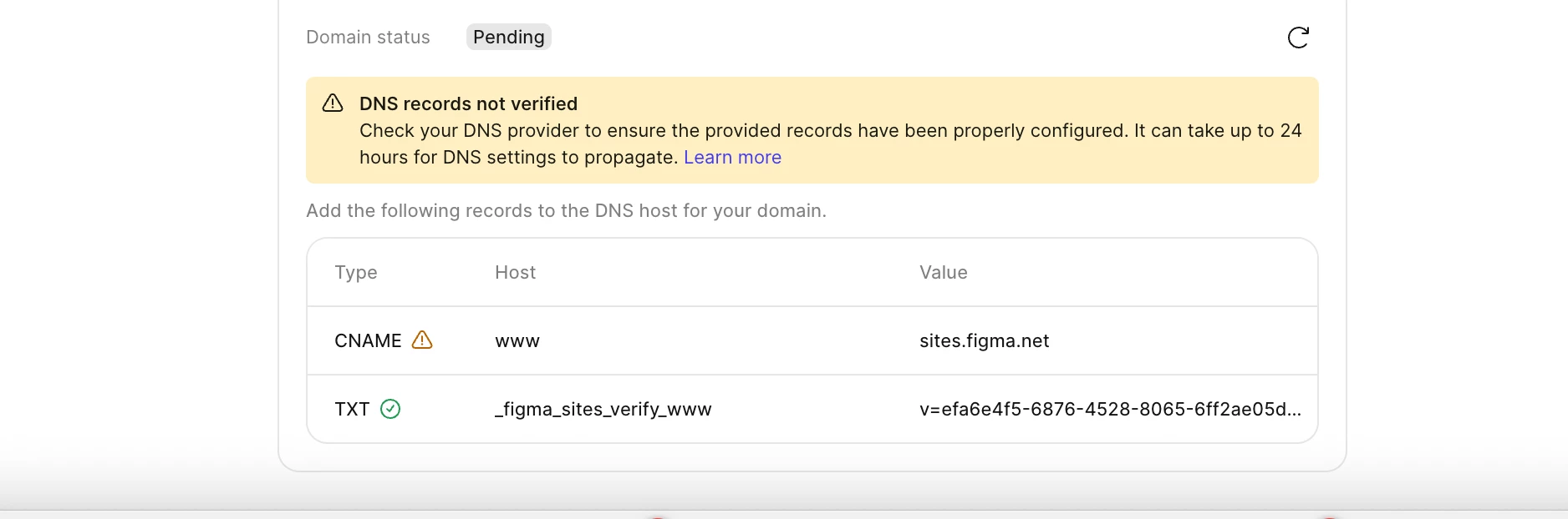

It looks like the CNAME record still hasn’t been verified:
This process is taking quite a long time. So far, we haven’t set the A record because we’re waiting for the CNAME to be verified first — otherwise, our current application would become inaccessible.
Could you check if that’s an issue on your side, or let us know if you can already see the record?
Thanks in advance!
