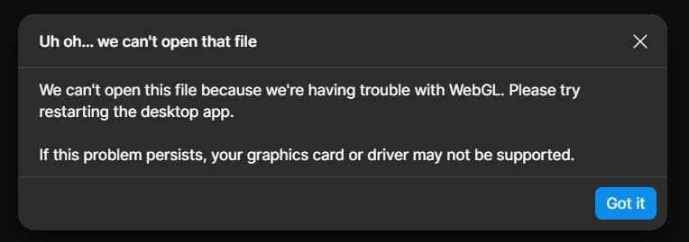

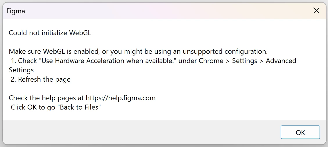

Hello Figma Team,
I am encountering a critical issue with the Figma Desktop application (Windows 11 ARM64).
Since today's update, the application displays the error message: "Could not initialize WebGL".
This problem is highly likely related to the GPU/driver detection in the latest version of the app.
My Configuration:
  • OS: Windows 11 ARM64
  • Device: ASUS Vivobook S15 (Snapdragon X Elite)
  • GPU: Qualcomm Adreno X1-85 GPU
  • Adreno Driver Version: 31.0.121.1 (the latest installed via Windows Update).
Diagnostics and Steps Already Taken:
  1. WebGL works perfectly when I use Figma in my browser (Chrome/Edge).
  2. The error occurs only on the Figma Desktop application.
  3. I attempted a clean reinstall of the Figma Desktop app (uninstalled, manually deleted GPUCache and Local Storage folders in %AppData% and %LocalAppData%) without success.
  4. I also tried to force the rendering via the command line with the --use-angle=gl and --ignore-gpu-blacklist flags, but the error persists.
Hypothesis:
It is highly probable that the latest version of your internal Chromium runtime has added my specific graphics driver (31.0.121.1) to a blacklist of unstable GPUs for WebGL on the ARM architecture, thereby preventing initialization.
Could you please confirm if there is a known blocking rule for this driver in the latest Desktop app update for Windows ARM, or if a fix is planned to allow this driver to use OpenGL rendering?
Thank you for your assistance.

Hey All, thanks again for your patience while the team worked through this issue!
As ​​​​@Natthan originally suspected, the team confirmed that this is an issue with Snapdragon X Elite drivers from Qualcomm, which is causing WebGL to fail. This is a minimum requirement of Figma, so because of this, the app doesn't launch as expected. The flag is forcing the use of Vulkan, which works as an alternative. To learn more about why this isn't working, you can reach out to Qualcomm directly. The workaround comes from this forum post.
Here are the steps to mitigate this:
  1. Create a shortcut of figma.exe
  2. Open properties of the shortcuts
  3. Add “--enable-features=Vulkan --disable-gpu-compositing” at the end of the target
  4. Apply and launch Figma with the shortcut
Please try this solution and let us know if you run into any further issues.
