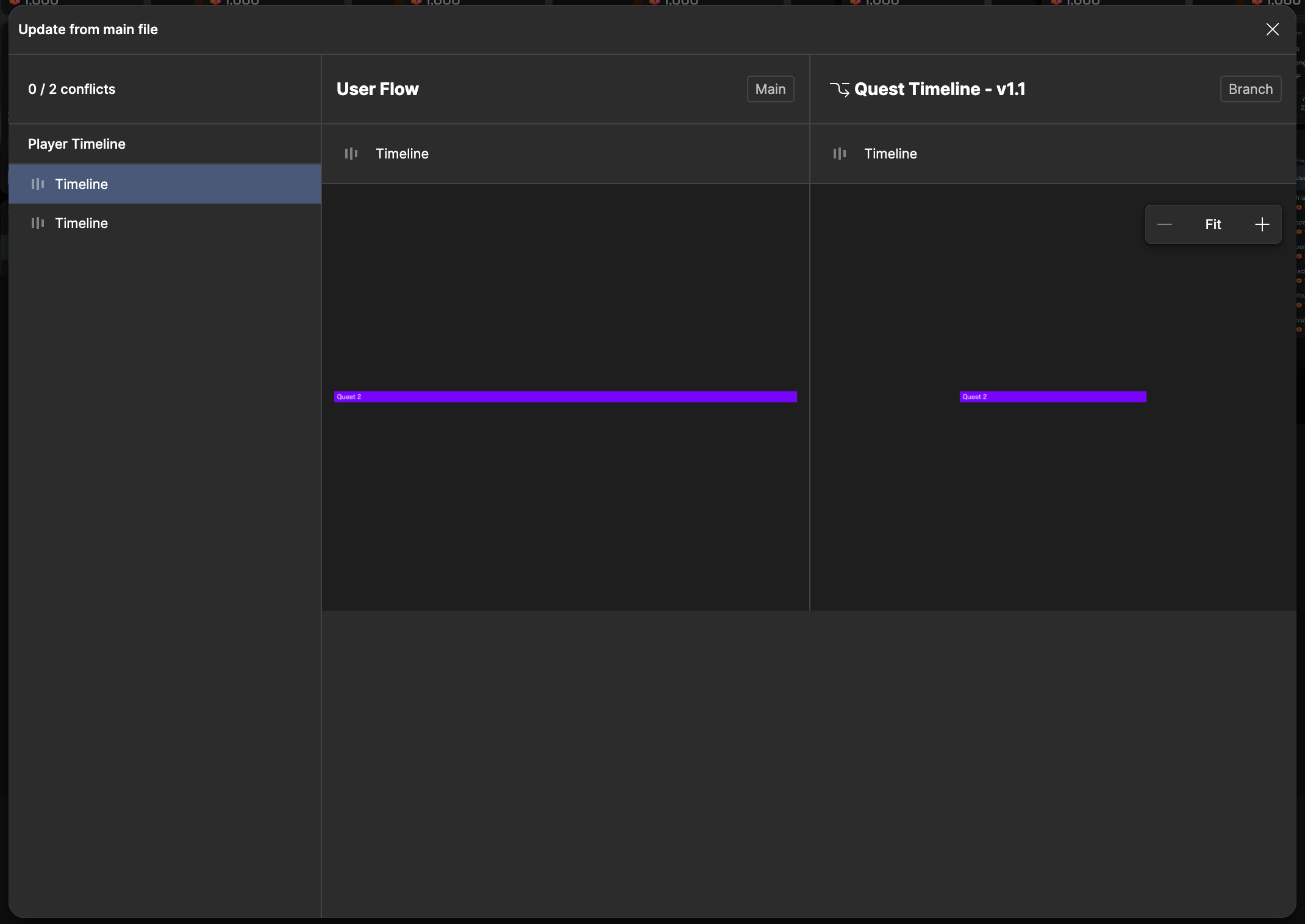

Hello!
I have created a branch of my design system to introduce the variables feature.
Bug fixes still happened in the main file.
Now I’m done with the variables and I want to merge them.
But when I start to fix the conflicts, Figma gets stuck.
No matter if I open it in the browser or in the standalone app.
Reloading it doesn’t help either.
Figma memory is still green with a maximum of 44%.
Is there any way to automatically settle on “keep main” to bypass the conflict modal?
Maybe there is another solution that will help me.
Many thanks!

same here. whenever i try to resolve conflicts in our component library it gets stuck. i eventually get through it but it’s a tedious, painful thing to do.
i never get to see the preview for both branches, clicking a button takes several minutes until it moves to the next item, i have to trust my knowledge of layer names to select the right version.
what i can do is click the “keep main” button multiple times (if i know exactly how many items i can keep from main branch) - it still takes a few minutes but at least it resolves a few items at once.
it just took me about 30+ minutes to fix 18 conflicts.
horrible experience and i’d really need to use branches but i’m considering moving away from it, cause this happens every time!
(side note: memory usage shows 18% for the file in question)

I’m stuck with the same. I don’t have options to select the desired branch to resolve the conflict.
Figma - 125.0.8
macOS - 15.3

Had to restart Figma. The conflicts are no longer there. Vanished magically.
