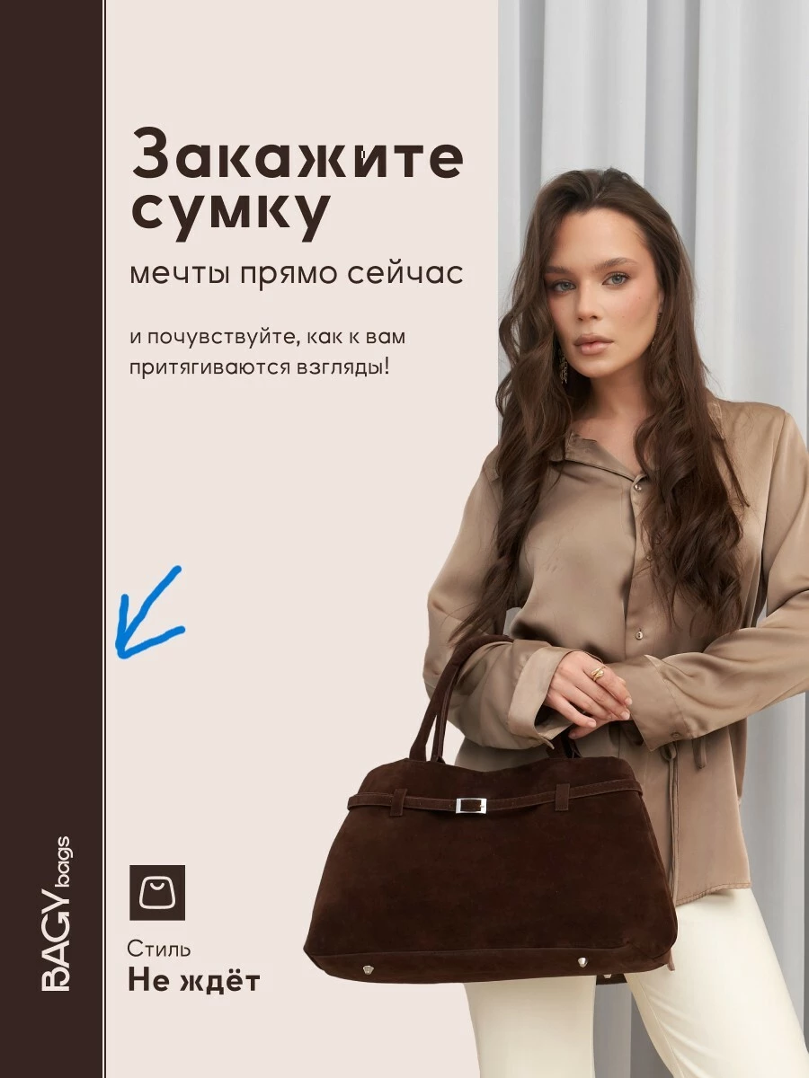

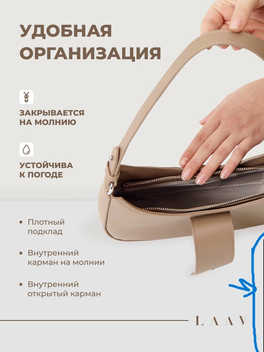

I've recently run into a strange issue when exporting frames from the Figma desktop app (Windows). Some slides/frames export with black bars on the edges (top, bottom, or sides) - but only in certain cases. Here's what's happening:
  • Everything looks totally fine in the browser version - no black bars there.
  • The issue only affects some frames, not all.

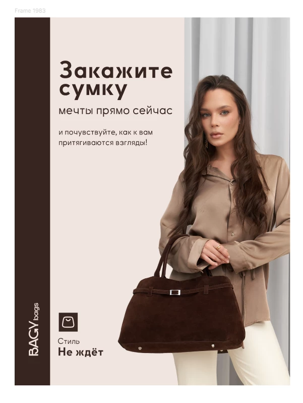

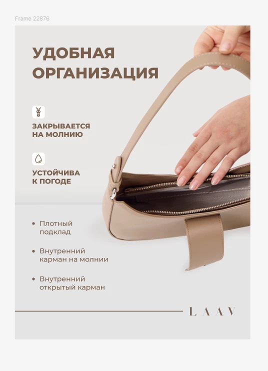

  • In the editor, the frames look perfectly normal - the black bars only show up in exported images.
