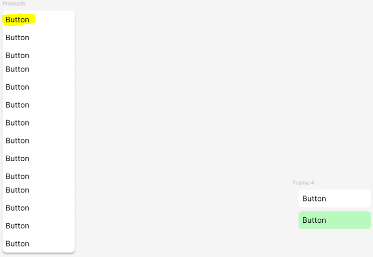

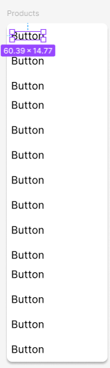

I’m having an issue with my variable list, particularly as it pertains to a drop-down menu I want to create. Below you can see the screenshot of the list (with the placeholder text “Button”). I’m trying to replace the placeholder text with the String variable I created “Grocery”. I want to replace all the placeholder text as well.
Figma isn’t letting me replace the placeholder text with my desired variable. I’m not sure how else I can replace the text because there’s no option to do so manually. Hoping someone can help with regards to this.

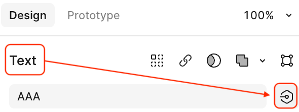

Here's how you can do it:
  1. Select the text layer.
  2. Head over to the “Text” section at the top of the right sidebar.
  3. If there's already a variable attached, first detach it by clicking the "Detach variable" icon.
  4. Then, simply apply your string variable by clicking the variable icon next to the text field.
Just a quick note: While string variables with "true" or "false" values can be applied in the Appearance section, this is specifically for controlling layer visibility – it won't change the actual text content.
You can find more detailed information and a helpful step-by-step guide here: Apply variables to designs > Apply a string variable

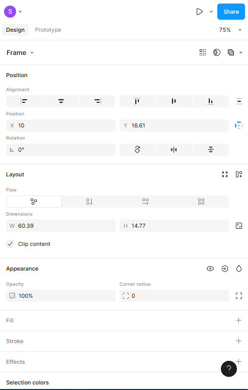

Thank you for your feedback. Unfortunately, I can’t seem to find the “Text” section in the top right sidebar. I can only find the variables option under “Appearance” and it still won’t show the variable strings I created.
Am I using a different version of Figma? Below is a screenshot of what I see in the top right sidebar when I click on the text “Button”.
Is there a reason why it shows “Frame” and not “Text”? Hopefully, i haven’t confused you with my question. Thanks once again.

If you see "Frame" in the right sidebar, that indicates you've currently selected a frame. Please check your “Layers” panel in the left sidebar to make sure you're selecting a text layer instead.
