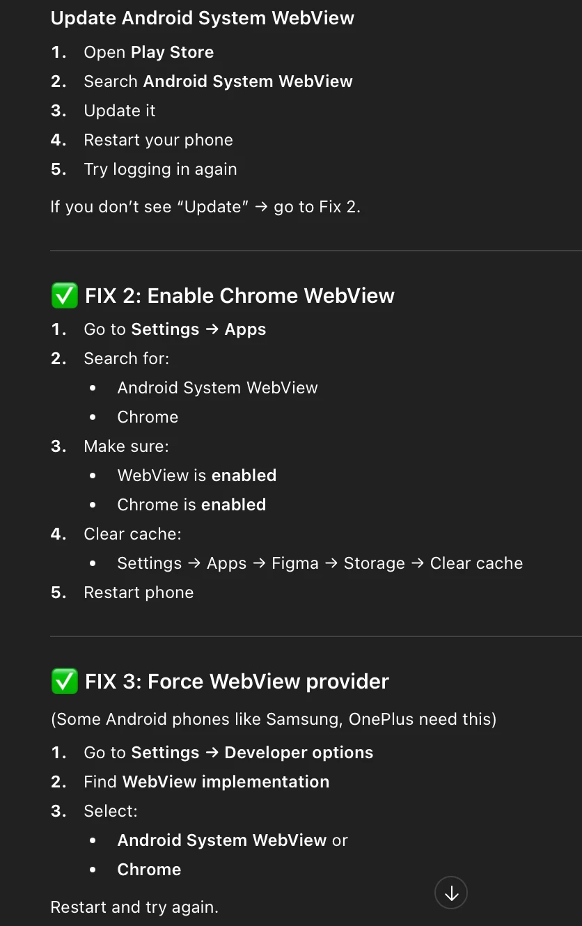

  1. Update chrome and make it as default application for browsing. now login again on figma app. this will resolve.
    If it doesn't, then find the attachment
