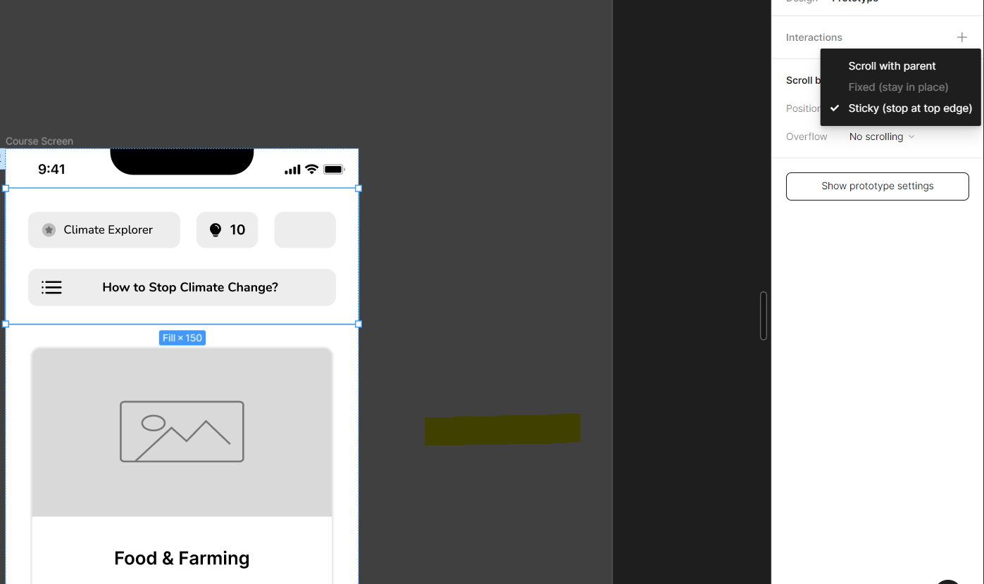

any idea why fixed option is disabled?

The main frame “Course Screen” Has an auto layout, so you can’t fix elements inside it, try removing the auto layout, and the “Fixed” property from prototype will be enabled again.
