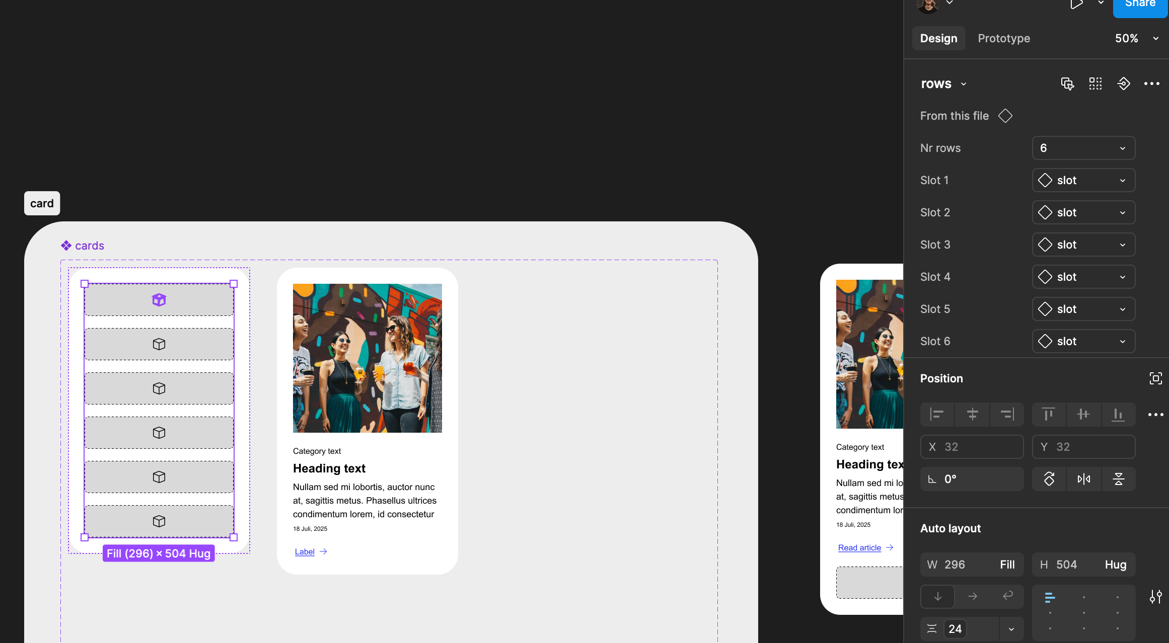

This image shows how the “blank-card” looks with the slot setup, on the card to the right of it i’ve changed the instance of a few slots and it looks fine. But if i change for example the text instance slot to a button instead, it will change back to the original slot size 64px in height and ignore the true height of said component instance.

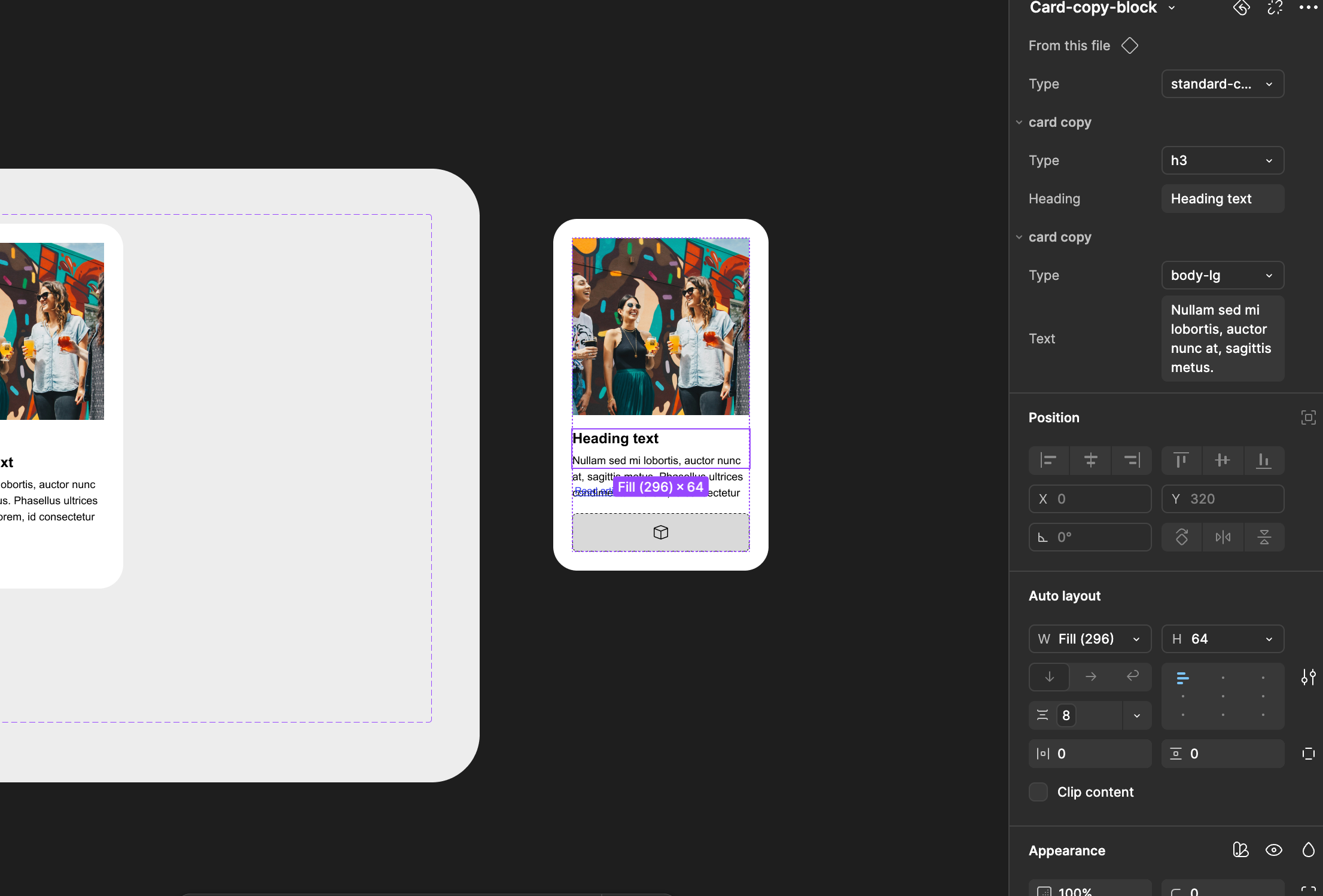

Here is another example where i had a text block component (that has two variants, one standard and another that has article card text content. If i change to the other variant type in the properties it resets at 64px height which again is incorrect as it inherits the wrong height from the default slot component.
