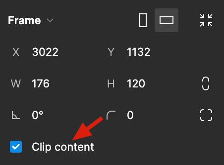

I’m not sure what is going on with the fill eclipsing the border. But the second issue you state may be that your menu component/container is set to clip the bounds of its contents. I would trying unticking ‘Clip content’ for your container frame and see if that does the trick.
