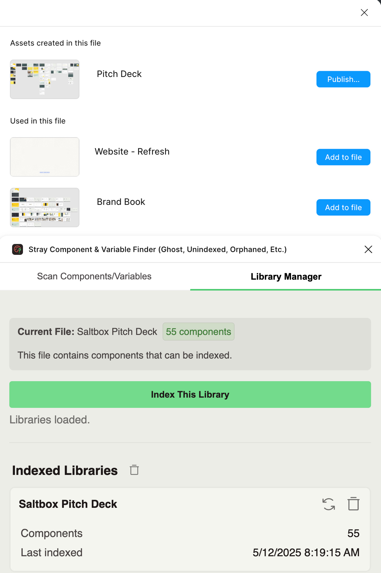

It’s not working for me. I have many text variables that I need to detach, but with the plugin scan I was only able to find components and not variables. The variables were brought in from the file called Website Refresh when I copied over some elements. What am I doing wrong?
Travis Tinney
Maya4 wrote:
If by ‘only able to find components’ you are talking about your second screenshot - The index library tab is used solely to ‘whitelist’ or ignore components and variables you don’t want to be identified as stray. So if the file that you are in right now ‘saltbox pitch deck’ does not have any variables created in it then it won’t show any on the index tab. If you are using the plugin to scan for variables in the ‘pitch deck’ file and it isn’t coming up with any results even though you know there are variables in it, then that would be an issue i’d have to look into.
Hope this help; if you are still having issues then maybe you can duplicate the target file, delete most of the content so there is only a small sampling of the text you are scanning that is not being recognized and share it and i can try and identify what is going wrong.

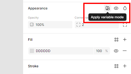

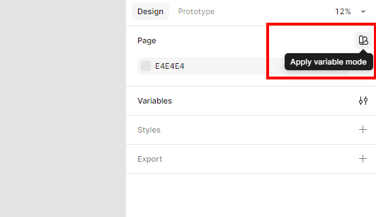

At first, I went page by page to check if any layer was still using the old variable. But that didn't remove the ghost variable collection. I tried a few plugins and checked hidden layers too — because if a layer is hidden, Figma doesn’t show the variable info in the right panel, so it's easy to miss.
Page - Apply variable mode
Appearance - Apply variable mode
Later, I used the "Apply Variable Mode" tool. I checked each page — if the ghost variable still showed up in the dropdown, I clicked into each section, then frame by frame, layer by layer, until I replaced everything. It took 2 full days, but finally the ghost variable disappeared from the dropdown.
