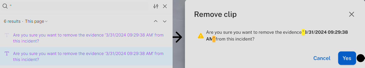

Any update? This issue still occurs in the latest Figma Windows app.
Example below I searched for double quotes " (U+0022) and it returned matches which contained ‘
