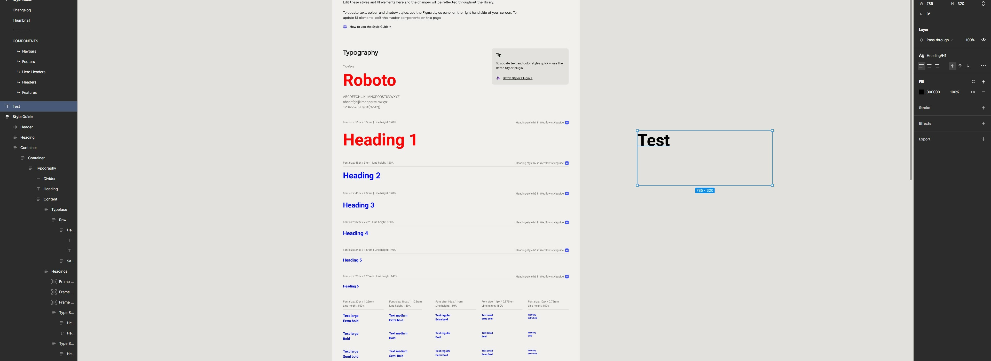

Thanks for your reply. If you look at this screen shot, you can see the H1 heading has a style, the size has changed but not the color.
![Screenshot 2023-09-25 093306|690x320]
(upload://xXfCdnt0YRepdn0cgQCaEBAWVU4.jpg)

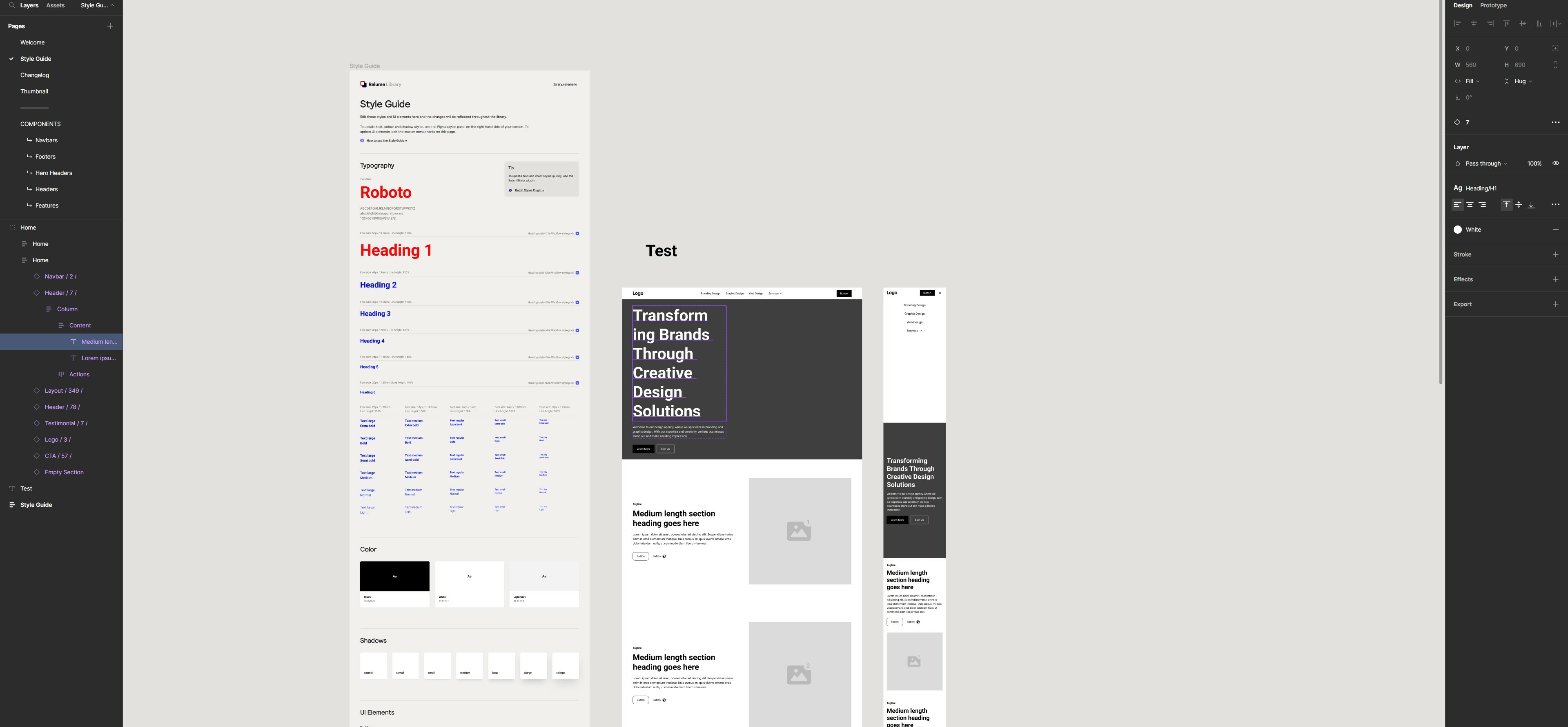

Then this shot shows the H1 with the red style

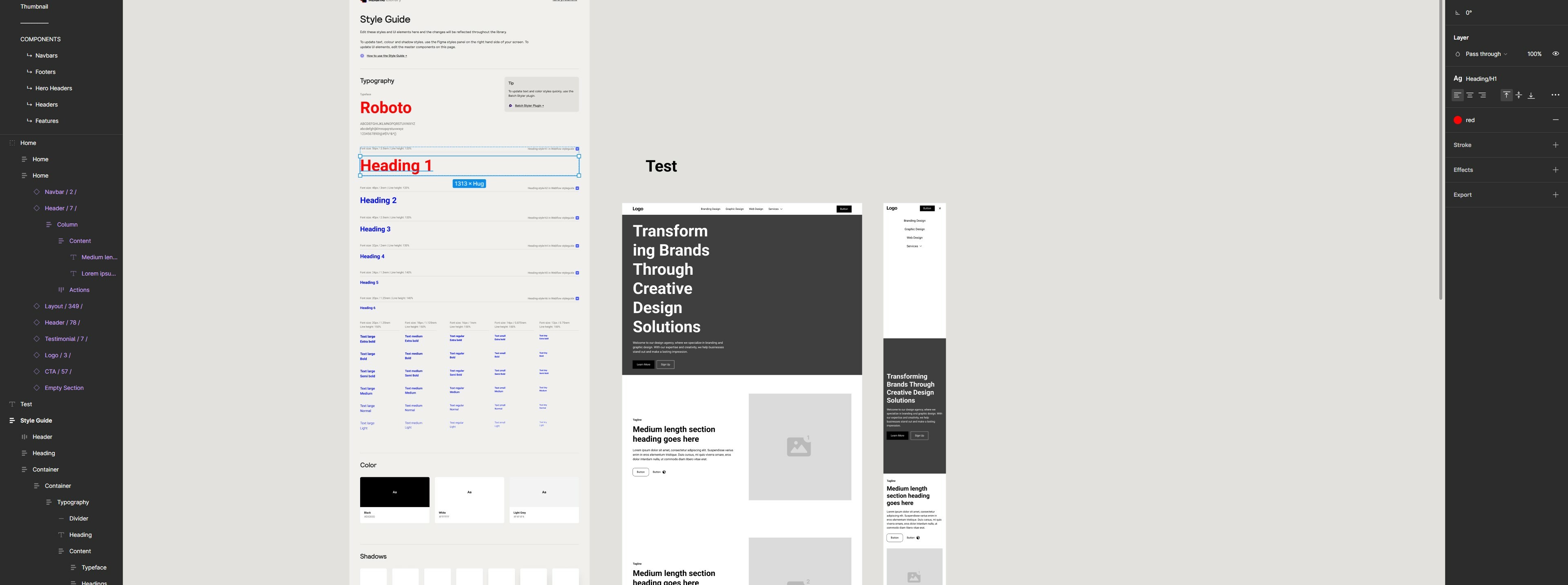

Other shot…

In the last two screenshots you provided, you can see that the “red” color style is applied to one object, and the “White” color style is applied to the second. And the “Test” object (from your original post) does not have a color style applied at all. Just apply the desired color style to it.
