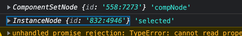

//log of these two
Here the first case we got a ComponentSetNode and 2nd time we got InstanceNode
So my question is how can I convert the 2nd InstanceNode to ComponentSetNode?

You cannot create an InstanceNode from a ComponentSetNode, so use the clone() method. In addition, you don’t need to create an instance.
It’s not entirely clear if you want the InstanceNode to be nested within a variant in the component set, or do you want to detach the instance and create the variant?
If the first, then create a new ComponentNode, insert the selected instance into it, and then combine as variants.
If the second, then create a new ComponentNode, detach instance, insert the selected frame into the component, and then combine as variants.
