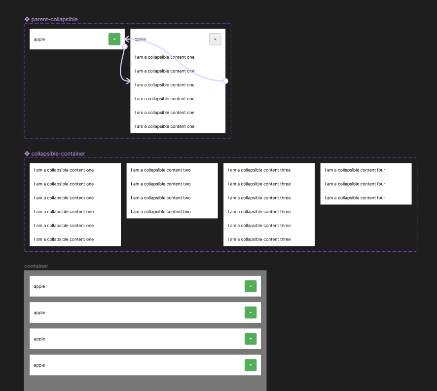

How I implemented it by, creating parent-collapsible component variants, namely collapsed, and uncollapsed.
The state uncollapsed has another component instance included that is named collapsible-container.
So when I have say 5 collapsible UI on one page, I have 5 component variants in collapsible-container. I assign each variant in the parent-collapsible’s uncollapsed variants.
