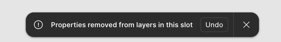

Wrapping/converting to slots breaks overrides but not for all

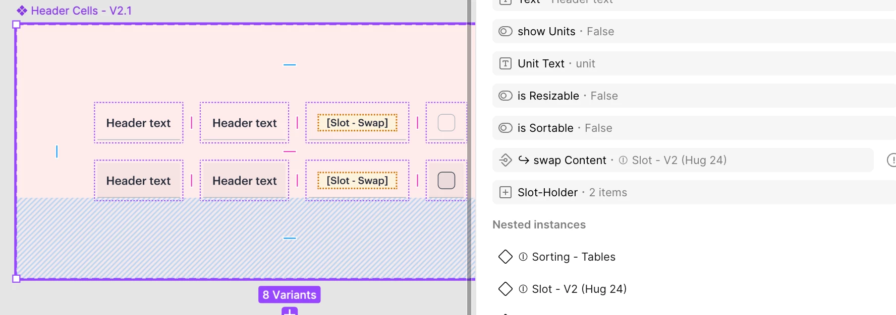

We're migrating our design system to Slots, and, like most designers, we're using slot placeholders and instance swaps as a workaround. As a result, we now have multiple components with placeholders that have been replaced by local instances containing content.
When we wrap or convert component frames to slots, the override resets.
BUT this is dependent on the account. In my work account, it is resetting the swapped instance. However, when my colleagues apply the same wrap to the same component, the resetting does not occur. I also tried in another private account, and resetting also does not occur.

Hi again ​@Oleh_Ulasyuk!
I just heard back from our team and the intended behavior is what you see in your work account; we actually just released that change which also explains why it seems inconsistent, and why you see the message just above the toolbar that states “Properties removed from layers in this slot”. If your colleagues reload their tabs, they will see the same behavior you see. For a bit more info, you can also read this section of the slots help article.

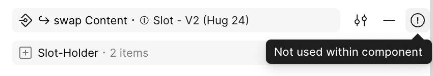

Its very hard to understand why Figma would silently remove this functionality.
My experience is now that the instance swap is removed in the variant level, but not at the variant set props, its just marked as “unused”. But even worse, every single modified instance using the previous technique will break.
This will making the migration process 100% breaking changes. Is there any rational for the change to help us understand?
