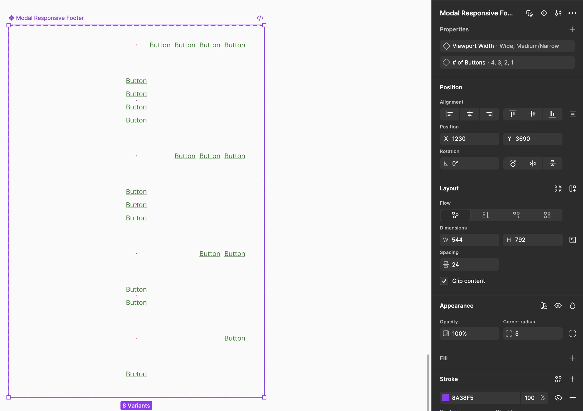

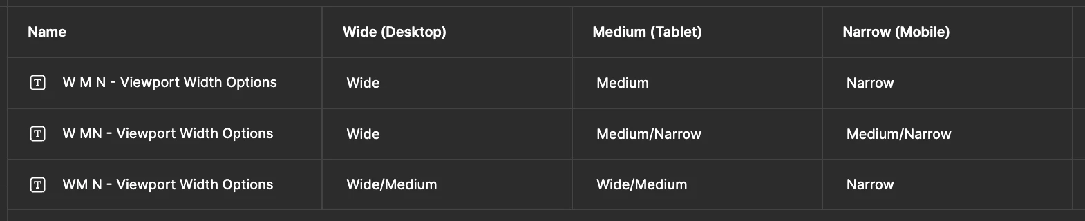

Thanks ​@Jaycee Lewis - here’s an overview but let me know if there are other specific details you need.
We are trying to implement breakpoint mode by leveraging a text string variable connection to the components’ breakpoint variant property.
When switching between breakpoint modes, content overrides are being reset to component content defaults. Our goal is to preserve content overrides.

  • The variable + mode setup: the string variable, its values per mode, and which variant property it's bound to
