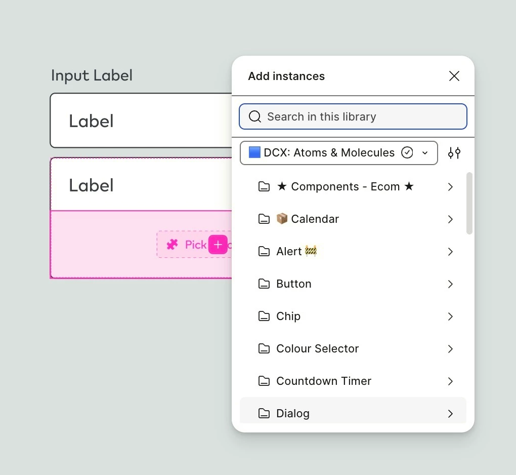

How it looks when called from another file.

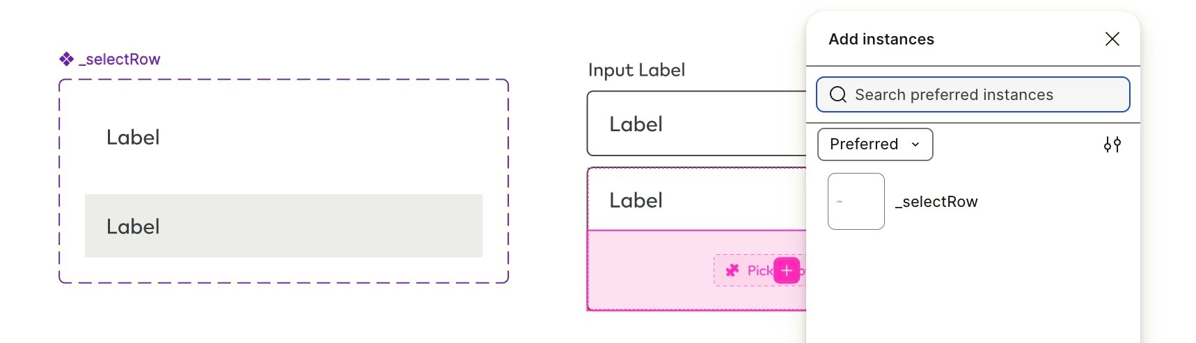

How it looks inside the library file.

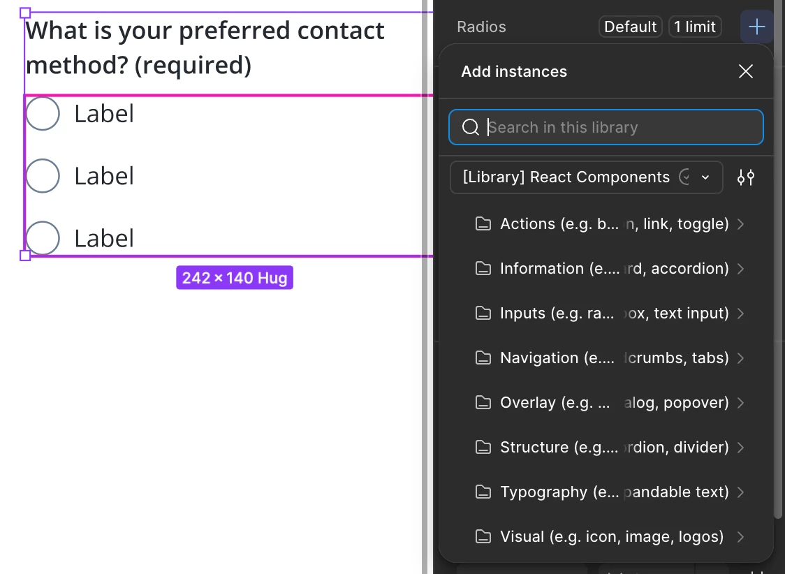

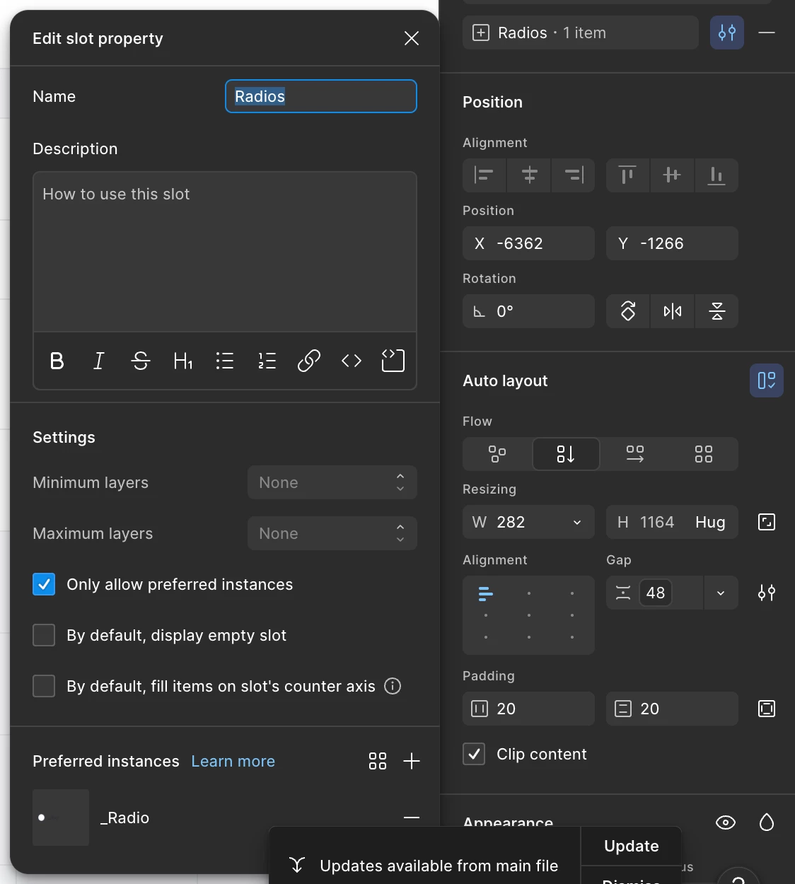

​@Jaycee Lewis Yeah, I’ve attached a couple of videos and images for reference. The steps I took are:
  1. Create a slot in the component
  2. Add the unpublished component as a preferred instance
  3. Insert an instance of the component into another file
  4. Go to add an instance into the slot
  5. Observe that the list doesn’t show the hidden component
This is the case for components that’d previously been working with unpublished components, as well as components created after the issue started happening. I’m on macOS 26.5.2 and the Mac app version of Figma (126.2.10) but it’s the same on the web version too (Safari 26.5.2.).
Component setup
Instance when trying to add more of the unpublished component to the Slot
