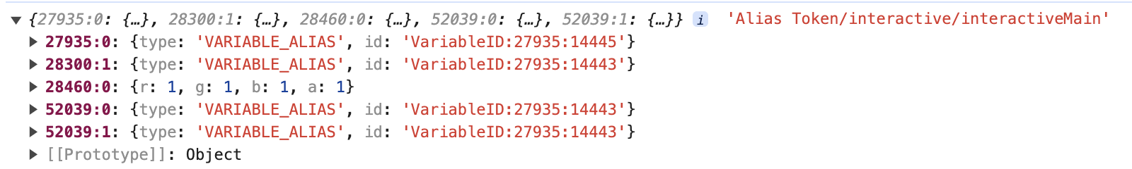

The format of the value obtained by variable.valuesByMode is { [modeId: string]: VariableValue }. For example, a value like { '522:0': {r: 1, g: 1, b: 1, a: 1}, '522:1': {r: 0, g: 0, b: 0, a: 1} }.
I wrote a process that changes this key to the mode name. For example, a value like { 'Light': {r: 1, g: 1, b: 1, a: 1}, 'Dark': {r: 0, g: 0, b: 0, a: 1} }. Light and Dark values were taken from collection.modes.
However, one variable returned an unknown third modeId. The program crashed because of a modeId that does not exist in collection.modes.

This is additinal information:
We are not using the Enterprise plan. Nevertheless, variable.valuesByMode for a variable returns 5 results.
Do you have any information about this defect?
