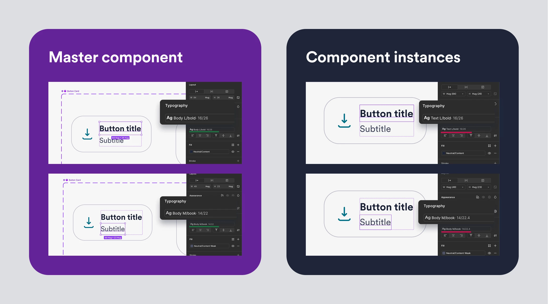

Issue 1 — Old style names remain visible
In some text layers, the instance still displays the old style name even though the main component uses the new style.
Example:
  • Main component: Body L Bold
  • Instance: Text L Bold
The instance is clearly showing the old style name, despite being linked to the updated style.

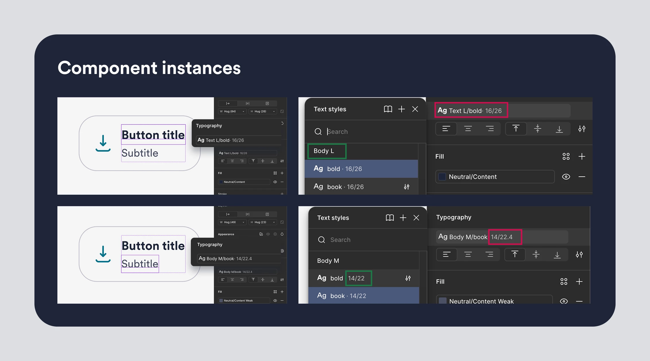

Issue 2 — Old typography values remain attached
In other cases, the style name appears correct, but the actual typography values shown are outdated.
Example:
  • Main component: Body M 12/22
  • Instance: Body M 14/22.4
The instance appears to retain previous values that no longer exist in the library.
The most confusing part
When selecting the affected text layer, the Text Style dropdown shows the correct style as selected.
In other words:
  • The layer appears linked to the correct style.
  • The dropdown confirms the correct style is selected.
  • Yet the style name and/or values shown in the UI remain incorrect.
This creates a situation where the layer appears both correct and incorrect at the same time.

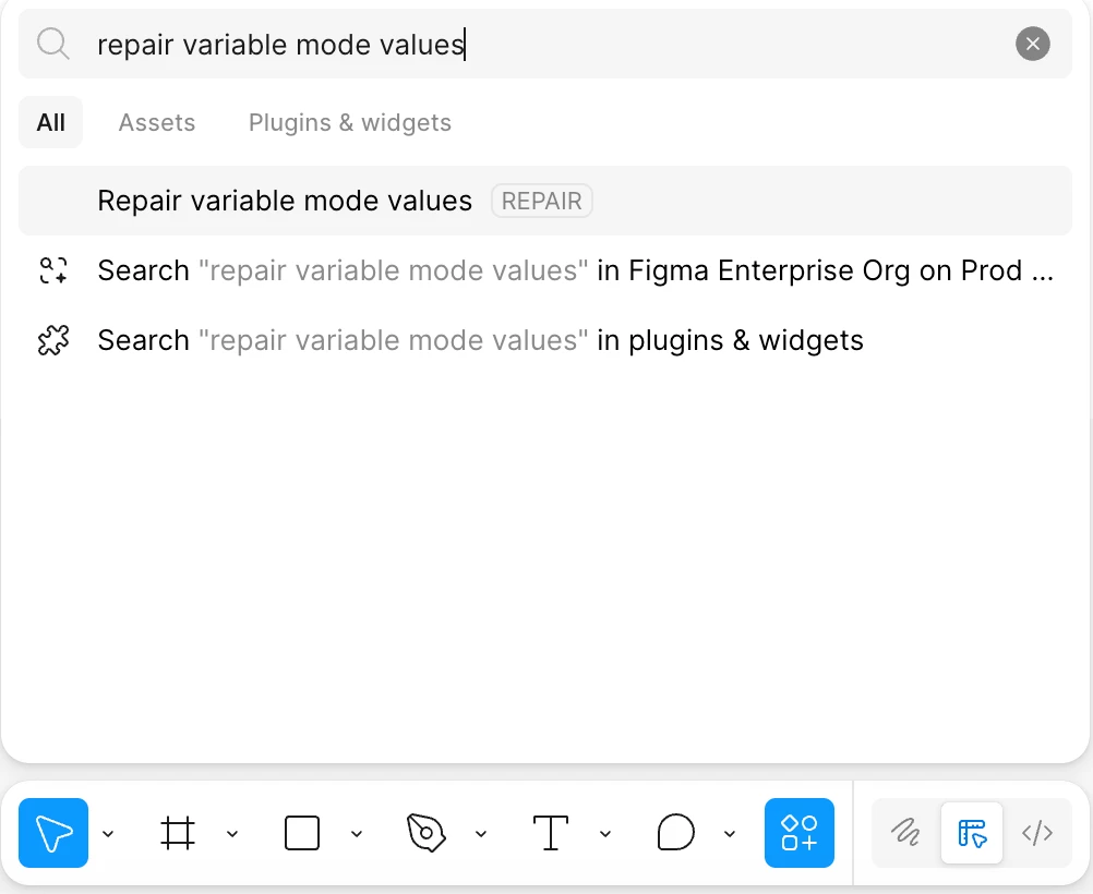

Let's work on this together! It's worth running a quick test to isolate whether the issue is with how the library is publishing or how the consumer files are reading it:
  • Open a fresh file in Figma Design and add the affected library
  • Drop in one instance of the broken component
  • Try running Repair variable mode values to see if that helps. You can access quick actions by using the keyboard shortcut ⌘/ (Ctrl+/)

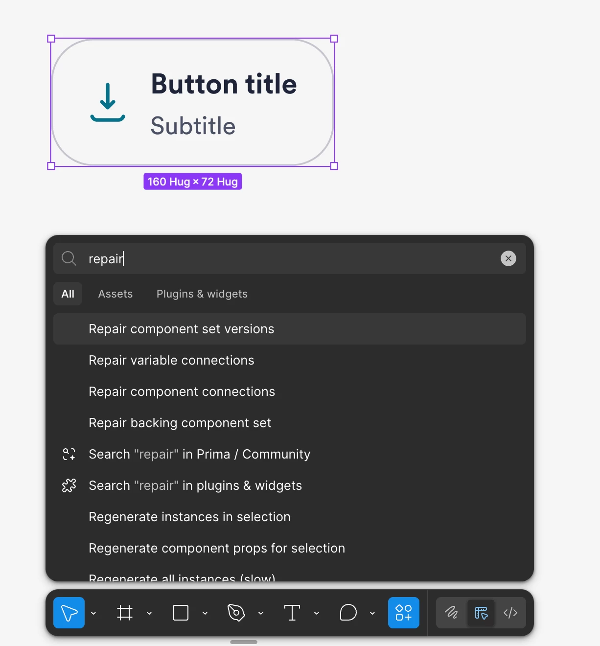

Regarding "Repair variable mode values", I don't actually see that option available in my Figma account. The only repair actions available through Quick Actions are:
  • Repair variable connections
  • Repair component connections
  • Repair component set versions
I tried "Repair variable connections", but Figma reports "Nothing to repair".

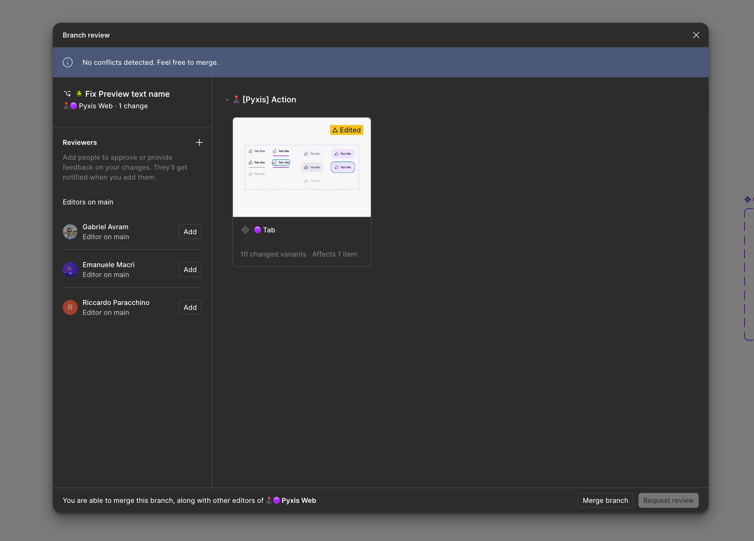

To be more precise, these are the steps I followed:

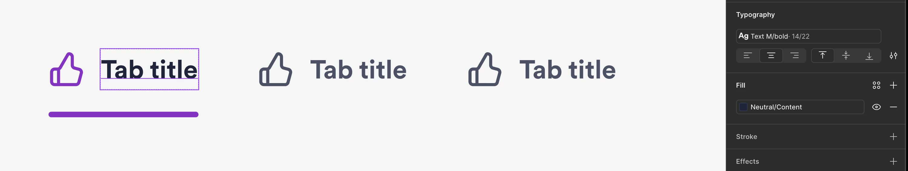

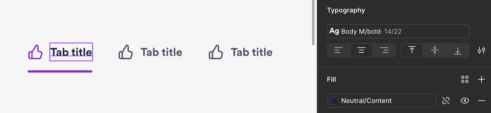

  1. Identify a component showing the issue (for example, a Tab component displaying "Text M" instead of "Body M").
    Incorrect Text M as associated text style
  2. Open the main library file that contains both components and tokens.
  3. Create a branch from the library.
  4. Select the affected text layer(s) inside the component.
  5. Replace the text content with temporary text.
  6. Immediately restore the original text content.
  7. Merge the branch.
  8. Publish the library update.
  9. Open a consuming file and accept the library update.
After applying the update, the component displays the correct text style preview (for example, "Body M" instead of "Text M").
So the component is definitely detected as changed and appears in the updates list.
