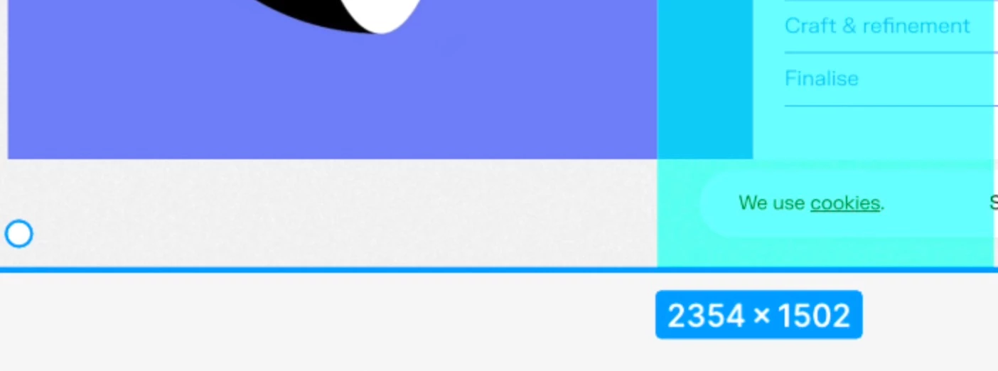

Screenshots placed in Figma show strange Rosa and Cyan blocks of color
Hello,
I'm experiencing a rendering issue with screenshots in Figma that appeared recently without any changes to my settings.
Problem: When I place screenshots in my Figma file, they display with unwanted colored boxes overlaid on them in the editor view. However, these boxes do not appear when I preview the file on Mac or in any other view mode.
Environment:
  • Figma Desktop App on Mac
  • Issue started recently (no intentional setting changes made)
What I've tried:
  • Reloading the file
  • Restarting Figma
  • Changing color profiles—the colored boxes persist regardless of profile settings
  1. Screenshot showing the problem (colored boxes visible)
  2. Screenshot showing the expected result (without colored boxes)
I've attached two screenshots for reference—one showing the issue and one showing how it should appear. The problem occurs consistently when inserting images in Figma.
Could you help me resolve this? Let me know if you need any additional information about my file or setup.

Gayani_S
Feb 12, 2026 5:47 PM UTC
Hey ​@tsk25, thank you for sharing screenshots!
Let’s try to narrow this down a bit:
  • Could you check if the same issue happens in the browser? (Figma supports: Chrome, Safari, Edge, and Firefox.)
  • Have you tried reinstalling the Desktop app?
  • Is this happening in one specific file, or across all files?
  • Is the colorblock around the image like a frame or does it seem to be part of the image?
Thank you for your help!
tsk25
tsk25Author
Feb 12, 2026 6:19 PM UTC
Hi ​@Gayani_S ,
thanks for your reply. Here are mine:
    • Yes, still happening in chrome.
    • Yes, problem persists.
    • across files
    • Yes, the frame is active on the image I uploaded. Sorry about that. The weird color is the large cyan block.

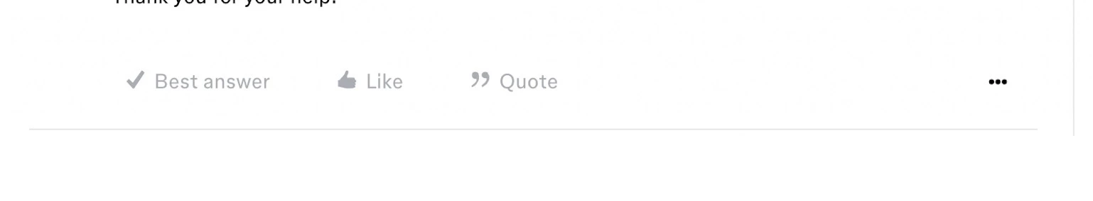

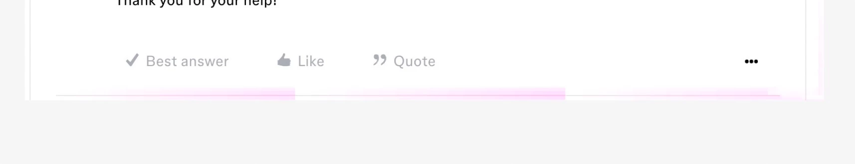

tsk25
tsk25Author
Feb 13, 2026 9:15 AM UTC
Screenshot inserted in FIGMA
Screenshot open in MAC Preview
Hello there, I’m still having issues with screenshots getting weird colors when pasted into figma, can anybody help me here please?
