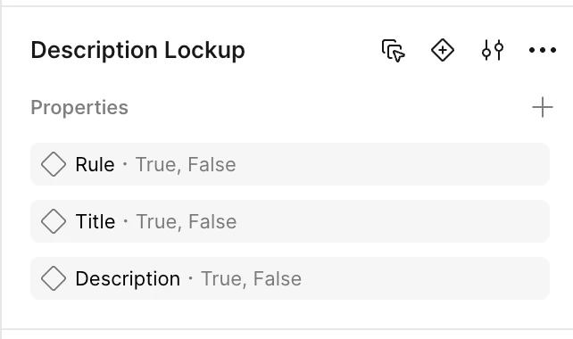

"Properties and values of this variant are conflicting" - but they are not

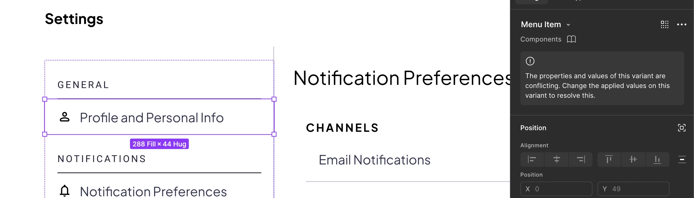

I have a design system that I published as a library. I’m consuming this library in another file for a slide show. Up until now, I never got an error when trying to access variants in the slide show file. But as of today, I am getting this message for a seemingly random assortment of instances:
“The properties and values of this variant are conflicting. Change the applied values on this variant to resolve this.”
I don’t get this error when interacting with variants inside the authoring file.
I looked up this error message on the Figma forum, and it says it appears when Figma detects that two variants are identical, regardless of whatever they’re named. But in my case, the variants are absolutely not identical. They have many differences in names and values and they have never produced this error either on the authoring or the consuming side until now.
I saw that Figma dropped the “Slot” property recently (love it). I’m wondering if this update could have led to this error?

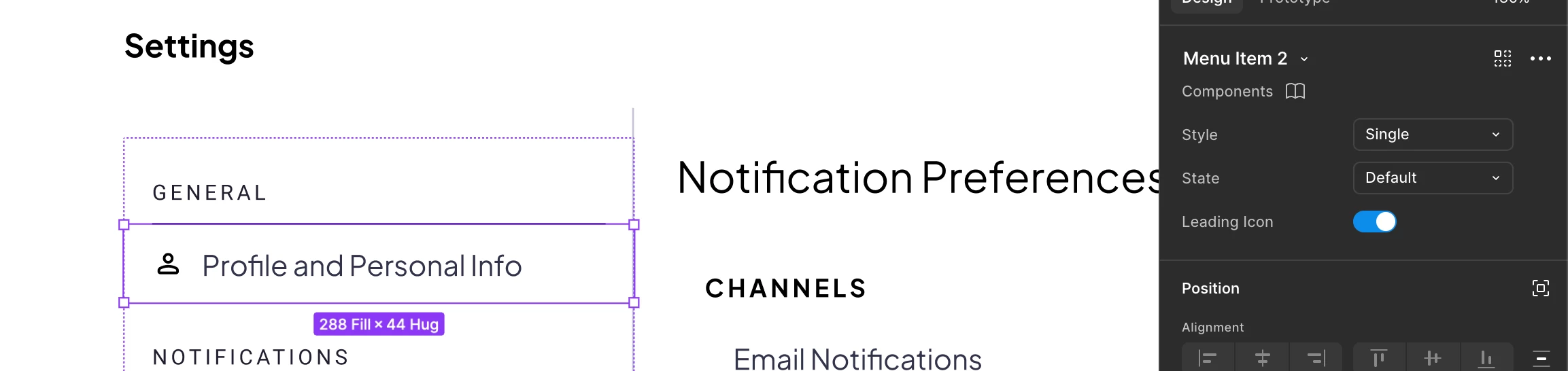

Having a similar issue.  We have a menu option component with an instance swap to add a chip, icon, badge, button etc to the right beside the text.  Replaced the instance swap with a slot.  It works completely fine within my component library file, and even lets me publish the component.
But when I add a child of this component to any of my design files, I get a property conflict error.  This error only exists in children placed in external design files, but does not show up on the parent component or children of it within my design system file.

Having the same problem.  When I place a child of a slotted component in a design file, the slot is just showing up as a regular frame.
However, if I create a child of the slotted component within my design system file, copy it, then paste it into the external design file, the slot is showing up properly.

I suddenly have one of my components that, even though it will publish just fine from the design system document, errors out and won’t let me set any properties when being added to another document. I’m getting an
error message. But only when trying to use it in other files. Inserting an instance within my design system document works just fine, and there aren’t, as far as I can tell, any conflicting values or properties.
I’m incredibly stumped on what the actual problem is here and why it magically appears only in secondary files. (And, in general, it would be awfully nice if these error messages could give some additional information on what the actual conflicting values are.)
