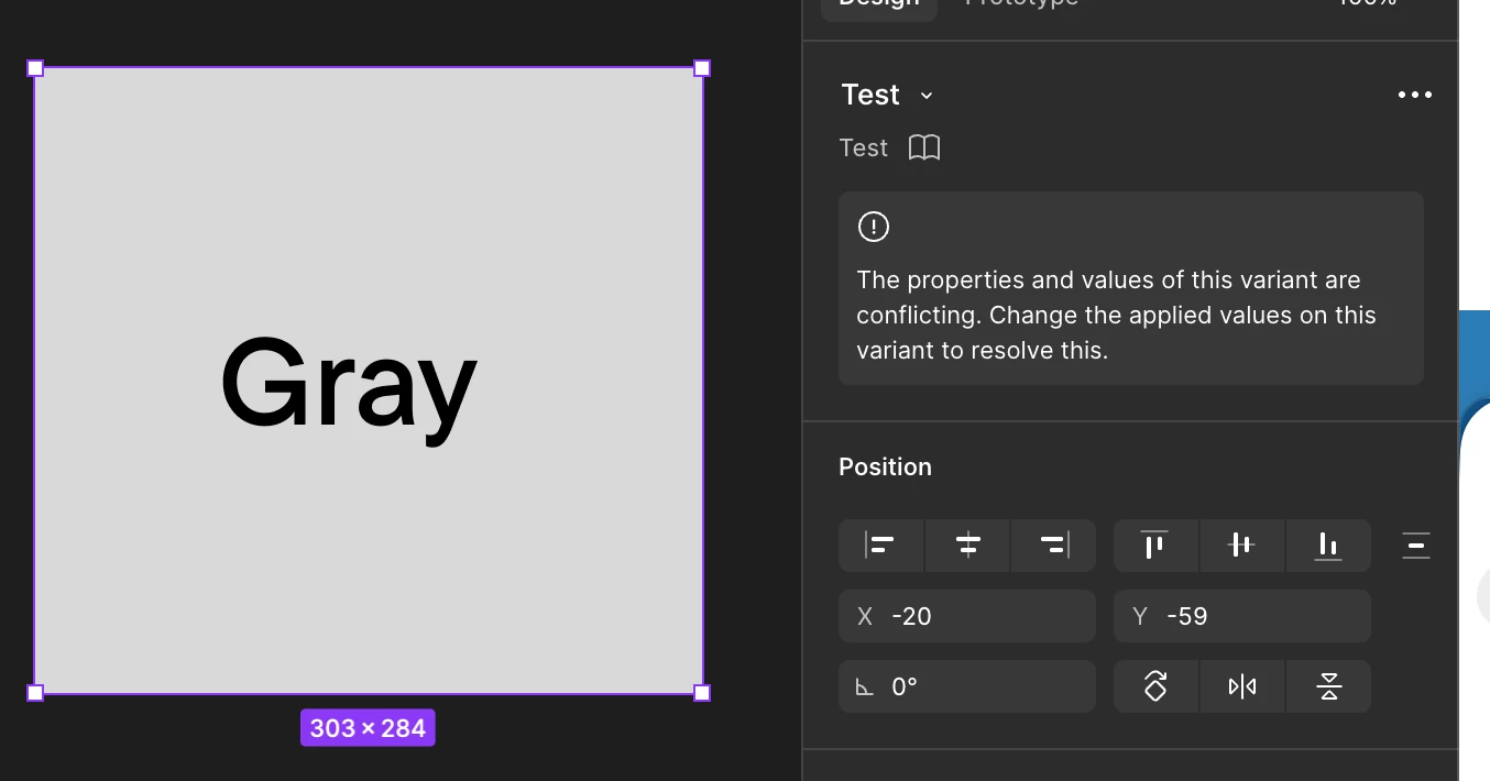

"Properties and values of this variant are conflicting" - but they are not
I have a design system that I published as a library. I’m consuming this library in another file for a slide show. Up until now, I never got an error when trying to access variants in the slide show file. But as of today, I am getting this message for a seemingly random assortment of instances:
“The properties and values of this variant are conflicting. Change the applied values on this variant to resolve this.”
I don’t get this error when interacting with variants inside the authoring file.
I looked up this error message on the Figma forum, and it says it appears when Figma detects that two variants are identical, regardless of whatever they’re named. But in my case, the variants are absolutely not identical. They have many differences in names and values and they have never produced this error either on the authoring or the consuming side until now.

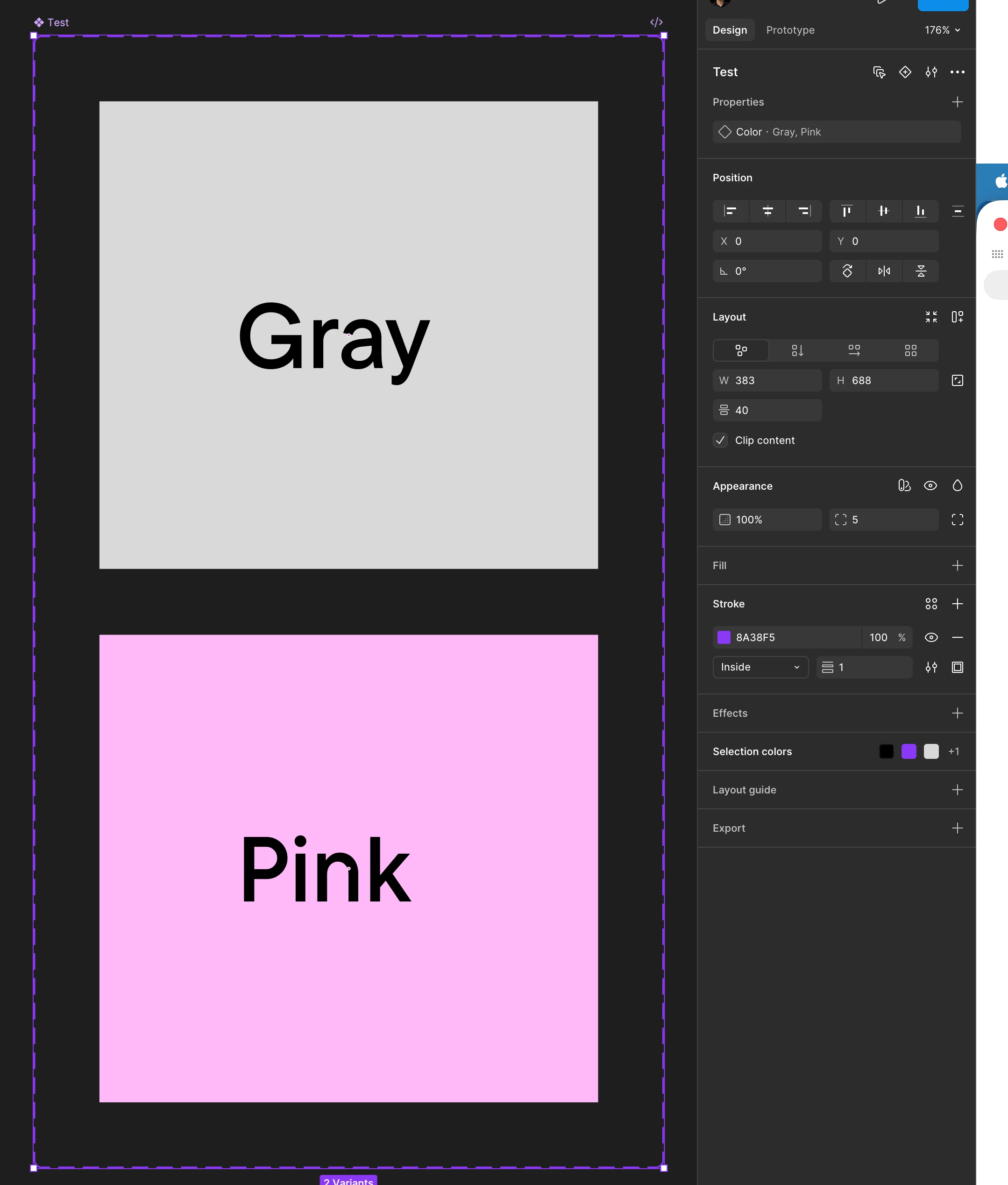

For my design library of components, any time I add a new variant the root component is breaking in all instances. I can use the component in my Library file and it functions. When I take that component and its variants and duplicate them exactly as-is as a new component, it will work. This unfortunately means that any time I make an update (such as adding a filled version of an icon), everything breaks and I need to create a duplicate one from the original in order for me to make this work.
This certainly seems like a bug as in the Main Component we are seeing no errors. We are able to copy and paste the exact main component and use that without issue. There is something likely out of sync here between the instance and the main component, and this certainly seems like a software bug.
The attached images show the duplicate components in the file. They are 100% identical as the Menu Item 2 was simply a copy and paste of Menu Item. In the file we can see the error showing when it’s set to Menu Item, and no error when set to Menu Item 2. This issue just arose today for me.
