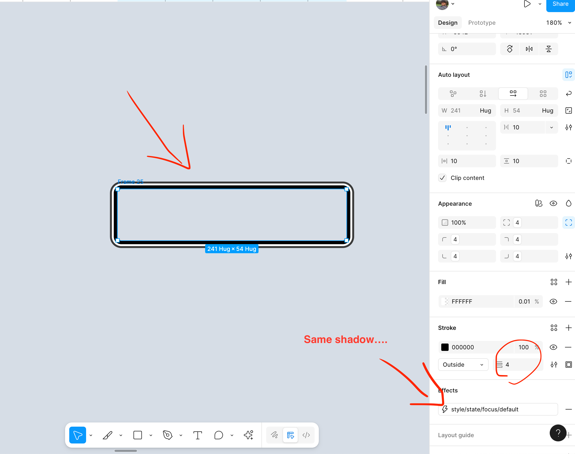

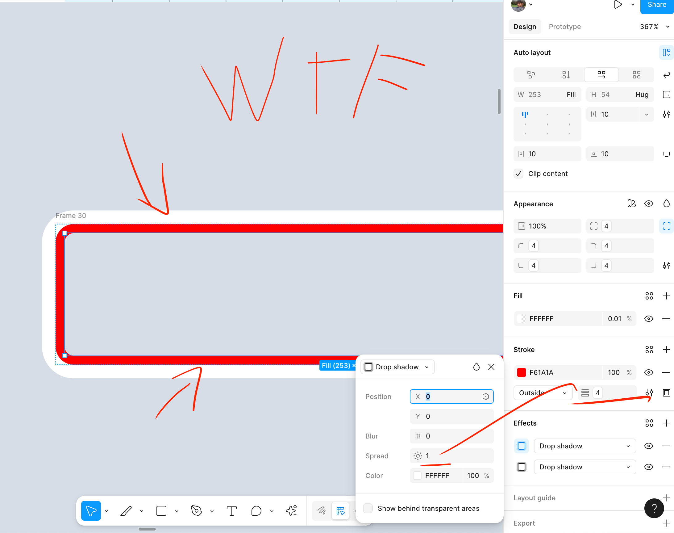

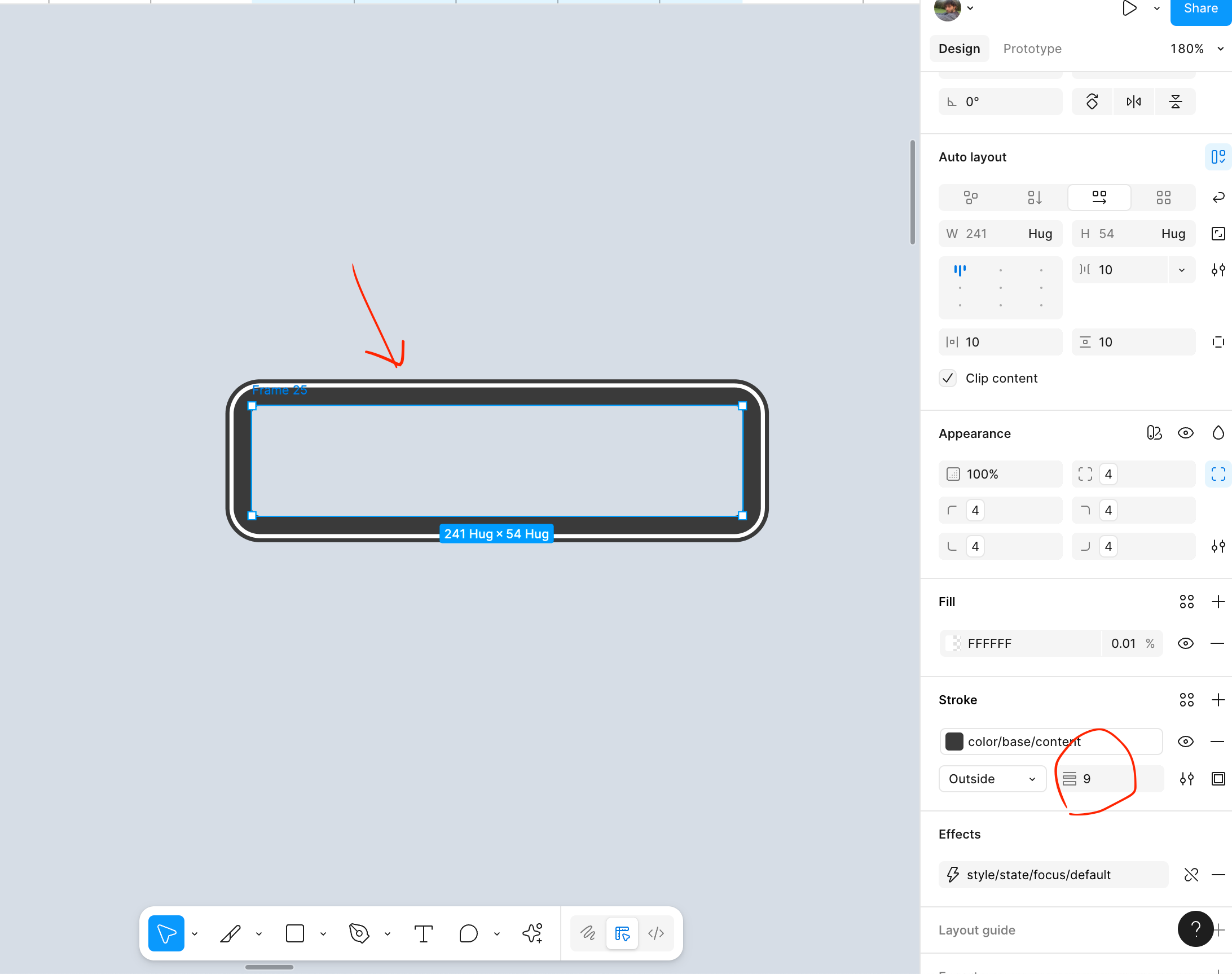

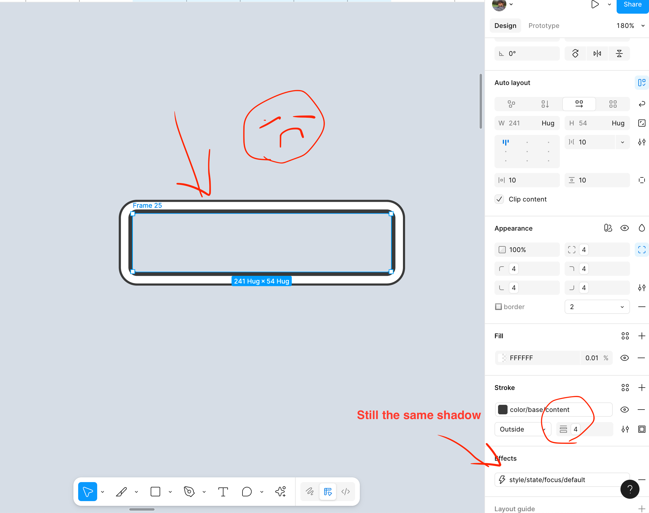

Dear Figma Team,
There is a problem that is causing me a lot of trouble lately…
When I add drop shadow on top of an outside stroke with no variable the drop shadow start after the stroke. The problem is that when I add a variable stroke width, the stroke goes above the drop shadow 😫.  There is 3 diffrent behaviors for the exact same frame and same shadow.
See screenshot attached
It is really jeopardize a hard deadline for me , please help…
(PS : the shadow is raw number so its not an interaction between 2 variables of the same mode in case you were wondering)
Matheo_Lesage
Jul 11, 2025 1:56 PM UTC
Just to ensure you that this is a bug, the drop shadow of 1px is bigger than the stroke of 4px….
