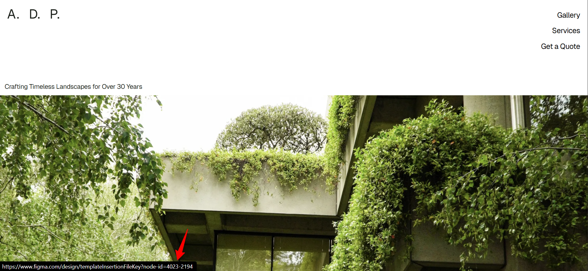

Minor Bug: Figma Sites URL Links Don't Work
I want to report a bug in Framer Sites.
The links don’t work as expected. Gallery should open the Gallery webpage.
But instead, it opens this node URL in the published site.
I used a template.
Other than that, love the new products and I’m very eager to try everything out. Will report bugs if the team’s is interested :)

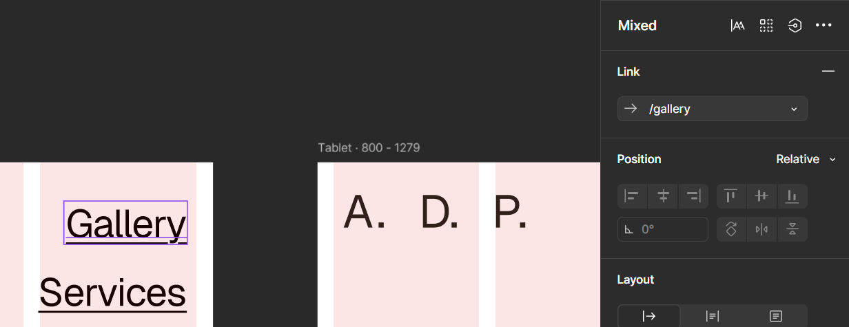

Our engineering team identified the issue where links were being set incorrectly when creating a new Figma Sites file from a template. This has now been resolved. Going forward, links created from a template Site should correctly direct to other pages within the Site as expected. ✅
💡 If you notice a link pointing to an unexpected URL or node, you can double check the destination in the Interaction tab (on the right side panel). More details can be found in this Figma Learn article: Add links to a site.
