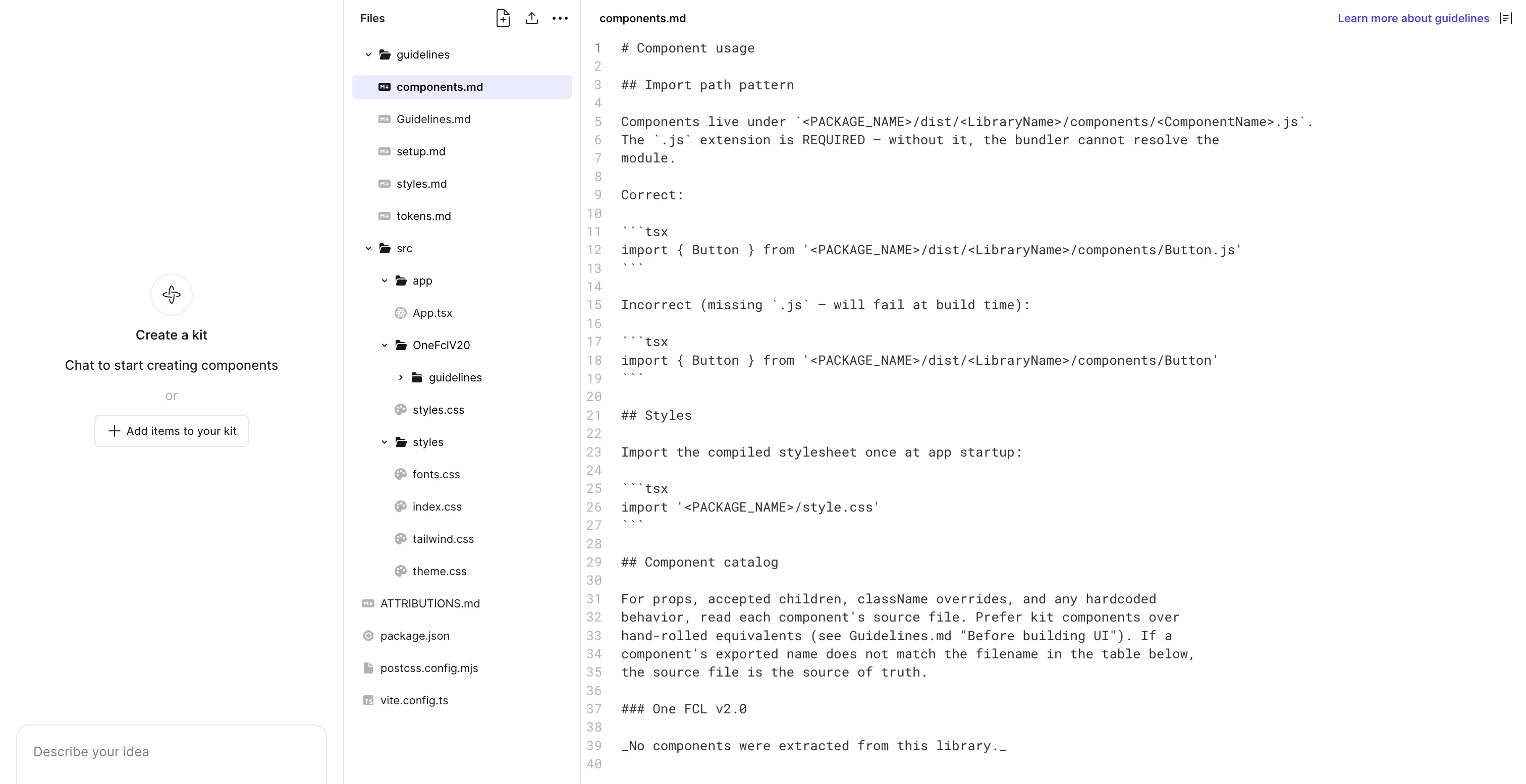

I have a design library with styles, tokens, variables, components etc all set up and published.
I’m trying to use this to create a kit in Figma Make but when I choose the design library, when I click in the components folder, it says ‘no components were extracted from this library’ and I don’t know why.

I have this problem too. My variables were carried over but none of my components were.

Also don’t see my components. It doesn't show an error. It’s just a text line in the components.md file. Is there no direct components import from a figma design system to make kit or it must be included in a npm package?

​@Jaycee Lewis when I go to components.md nothing is populated, just says “No components were extracted from this library” at the bottom.

I am facing a problem closely around this step. Once we Create a kit, using “Library Styles” and not the “NPM Package”, would it also pick up components from my library styles, such that when I prompt for a design in Figma Make, it will actually reference the actual components from that design system library.
I have been reading about this in Figma Make Kits page, but its not very clear, whether the components are also accessible using Library styles or we really need to download the npm package as well.
