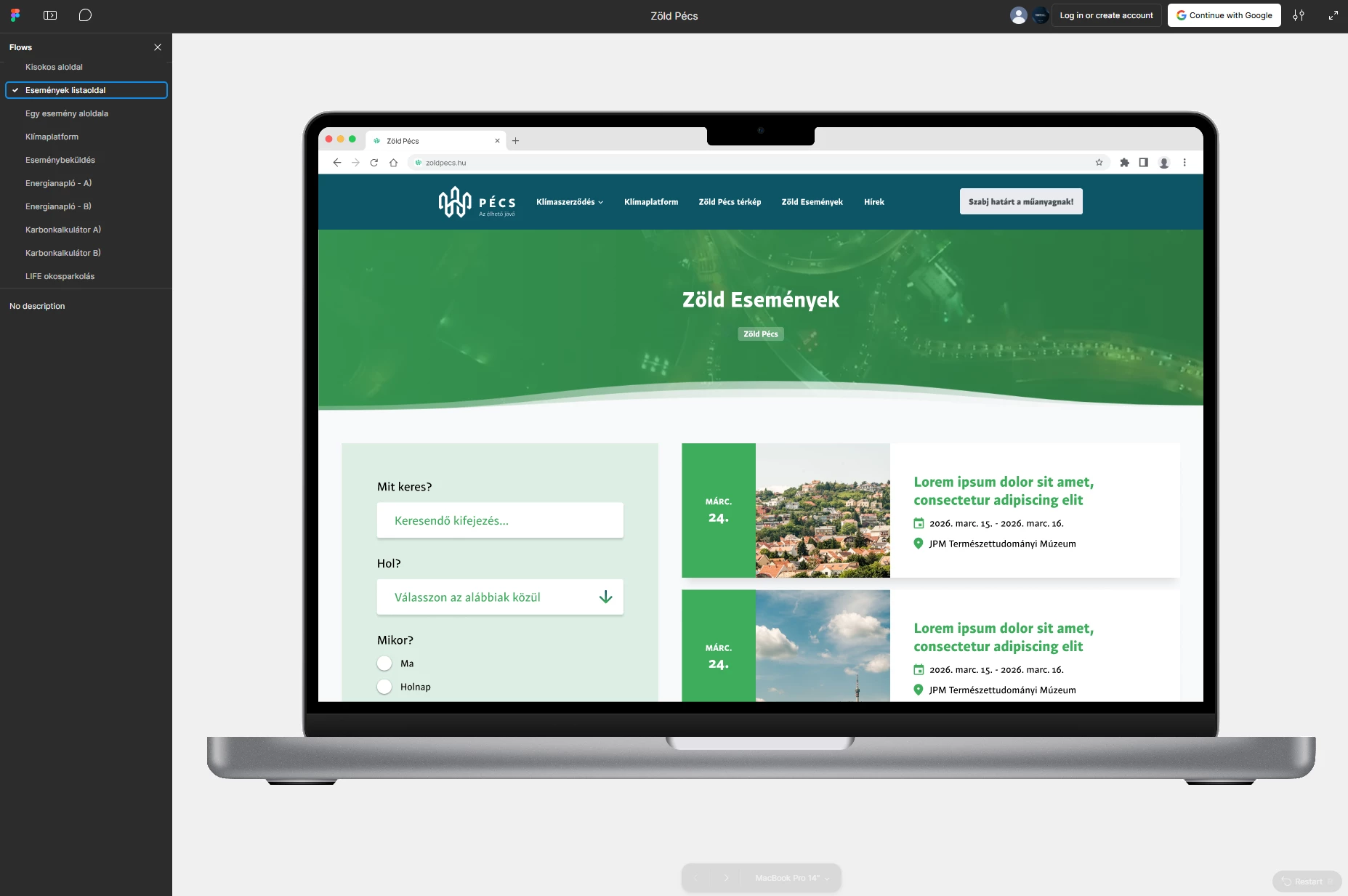

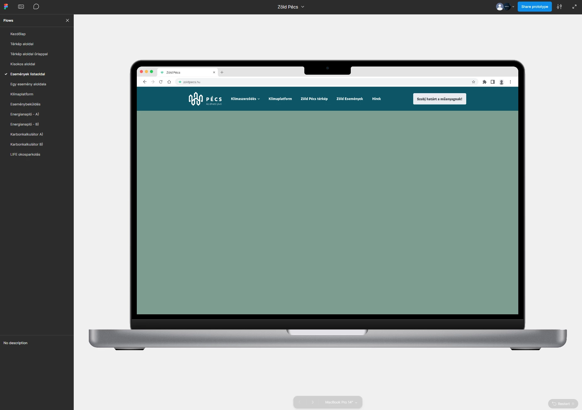

    It seems like any object with a blend mode other than “Normal” causes the prototype to show just a full screen of random color from the design. (I also noticed that an object or frame with glass effect shows the correct design behind it, and outside of it’s boundaries is still that random block of color.)
    No matter if the object or frame is positioned automatically within an autolayout or is in a fixed place, the problem still persists.
    The Flows that doesn’t have any blended elements show up correctly both in the desktop app and in browser (I tested only in Chrome). The Flows with blended elements seem to work correctly when opened in a browser without logging in with any Figma account (for example when opened in an incognito tab).
    Any update on this issue would be much appreciated.
    Desktop, logged in
    Browser, incognito
    Win 11
    Figma desktop app - latest version (no updates available)
