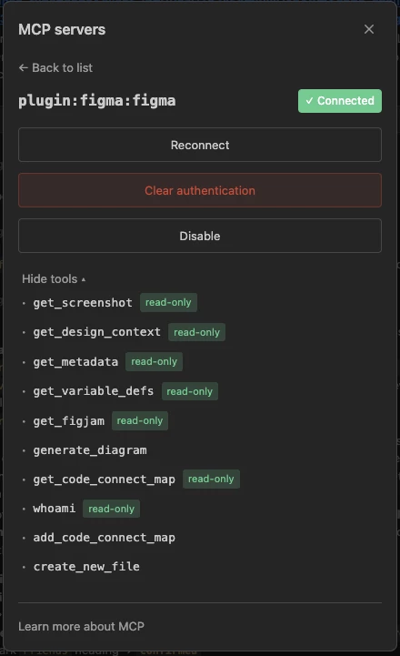

The generate_figma_design tool — documented as "Claude Code only, remote only" in Figma's developer docs(https://developers.figma.com/docs/figma-mcp-server/tools-and-prompts/) — is not available in my Claude Code session despite the Code to Canvas feature being officially announced on Feb 17, 2026.
My setup:
  - Figma MCP remote server is connected and working (all other tools like get_design_context, get_screenshot, whoami etc. work fine)
  - Full seat on a Pro tier Figma plan
  - Figma desktop app is running
  - Claude connector browser shows Figma connector version 1.0.3
The tool simply isn't exposed in the tool list. Is this a version/rollout issue on the connector side, or are there additional requirements to access this tool?

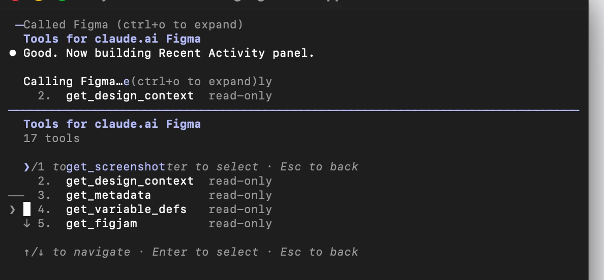

Same issue here, super-frustrating to watch a bunch of tutorials where things “just work” and then at the very early phases of your own tests end up realizing you can’t seem to be able to do any of that fancy stuff for real yourself, because the tooling just is not there.
Claude has not been able to help, it started hallusinating about generating code to be pasted into Figma’s Web Inspector view as a “solution” 😅
