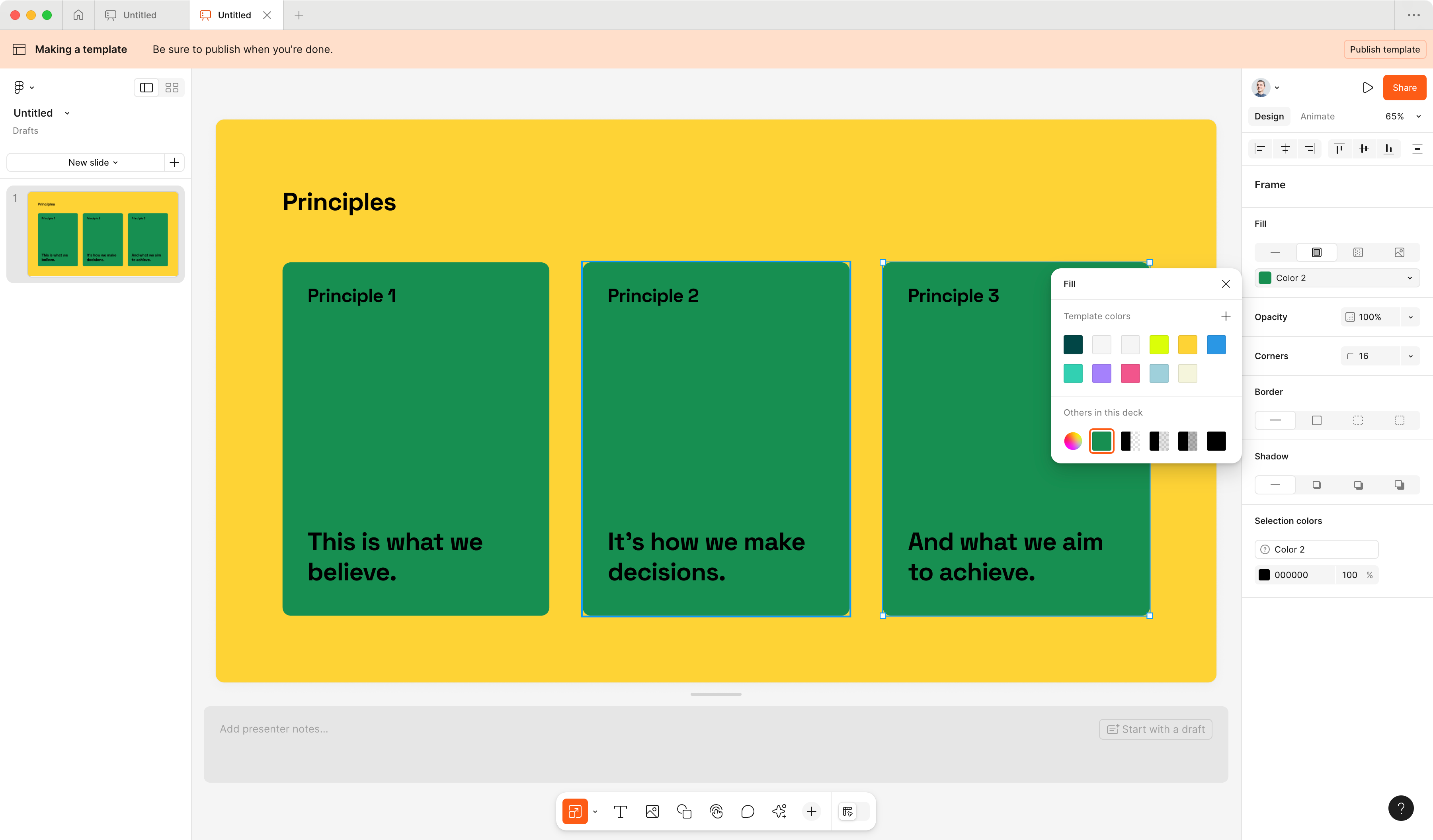

I’m creating a template in Figma Slides. I deleted the predefined colors and added new ones, but when I click “Remix Template Colors,” the old deleted colors come back (with broken links in the ‘selection colors’ overview). It seems they’re not actually removed. Has anyone else experienced this?

  8. This is where the rogue colours appeared on my slide. but they appeared as named colors i attached a screenshot with an example.
    • This dark green is not in my template en is called ‘color 2’ and appears when the remix button is clicked
