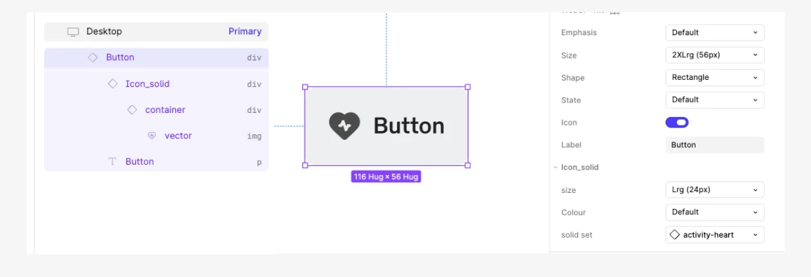

The structure of the button component setup is a shown below, where we utilise a dedicated nested icon component instance in the button component.

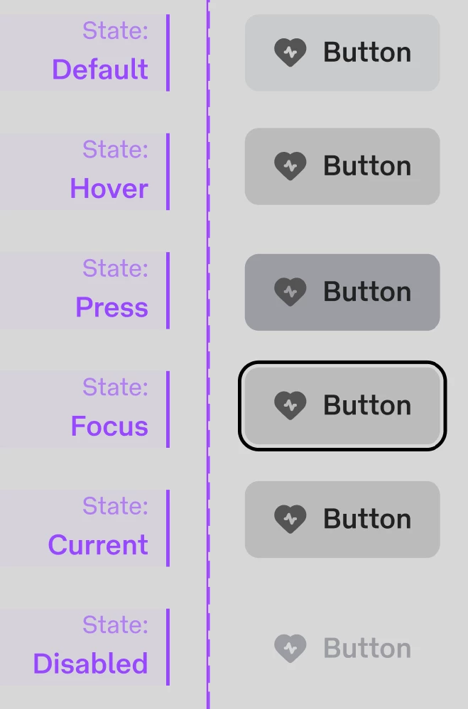

The master component for the button component looks like this:
Where the icon colour is the same for all states except for the disabled state. So technically the colour of the icon shouldn’t change and it doesn’t in Figma Design, but the issue is that it does in sites.

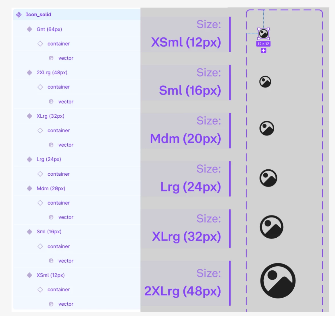

The setup for the icon component shown below follows Figma’s guidelines around naming, where all the vector layers for all of the icons are flattened and have the same name ‘vector’.
We setup this dedicated icon component so that we could easily manage being able to configure solid and outline icon sets inside of components as well as being able to control their colour, size and we are utilising the instance swap property to be able to change the nested icon.
The colour variable is applied only on the vector layers of the icon, with no other colours being applied to either the container layer or the component variant layer.

I also tried to add the icon component into a Figma sites and the same fall back behaviour seems to occur, where the icon colour just reverts back to the original hex black colour when interacted with.
