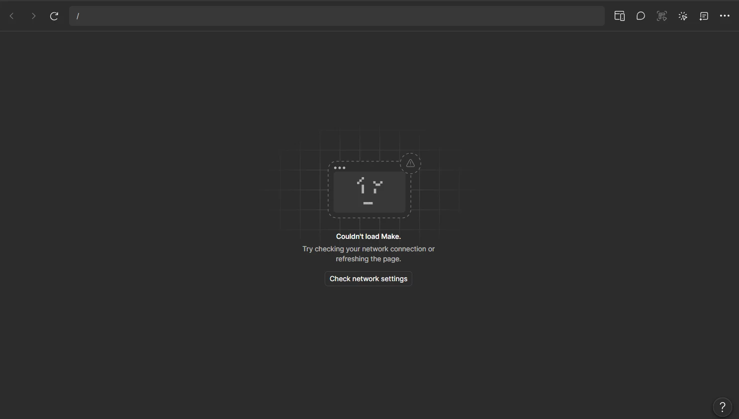

Figma Make is not working
i have been trying to make something from figma make but it is not able to load and giving me this error. i tried in desktop or web browser i get the same error. How to fix it? i have full credit

Hey ​@Eight, welcome to Figma Forum and thanks for the screenshot. Sorry you're hitting this with Figma Make.
The Couldn't load Make. error means Make can't reach its service to load. Since you're seeing it on both the Figma Desktop App and the browser, it's most often something on the network path rather than Make itself. A few things worth trying:

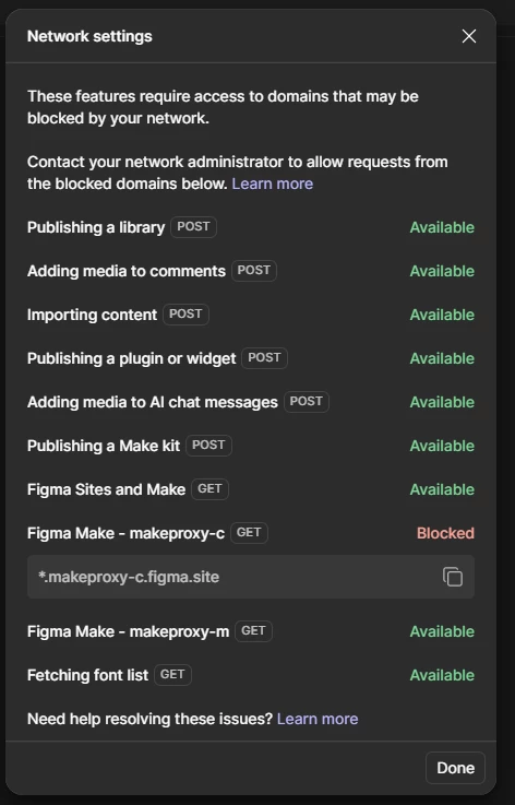

August 4, 2026
its showing this
Tom Reem
August 5, 2026
Hey ​@Eight — thanks for sending this over, the screenshot is very helpful. I can see that *.makeproxy-c.figma.site is being blocked by your network, and that's the domain Figma Make relies on to load — which lines up with the error you're seeing.
The fix is to get that domain added to your network's allowlist. Since it's your main network, this usually needs to go through whoever manages it (an IT or network admin) if it isn't one you control directly. This resource lists the full set of domains Figma recommends allowlisting, and the proxy-bypass steps if you're behind a VPN or firewall: Adjust your network settings.
