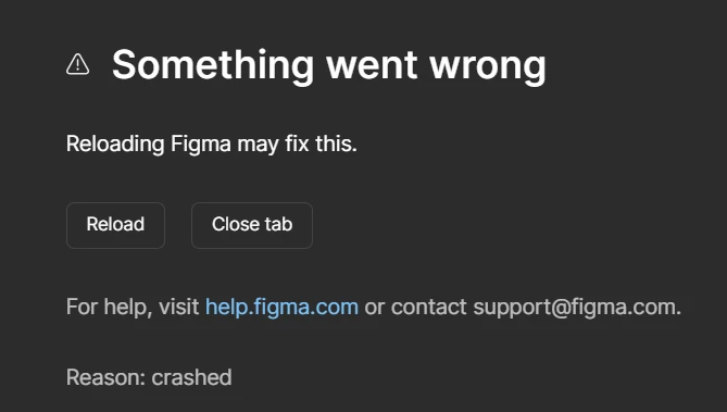

I have problem with Figma which is stopping be from using Figma as I experience crashes almost every time I try to scale or move any frame. It does not seem to be related to complexity of the design file as it happens on both projects which contain 3 frames and 2 components and projects which are much more complex (tens or hundreds of layers). This occurs regardless whether I use browser app or desktop app.
The error messages I get are mostly ‘Something went wrong, reason: crashed’ or something what seems like ID of the object I was manipulating (even when it is just one blank frame).

Two days ago I even reinstalled my operating system (Windows 11) but crashes keep happening even more often I would say. It is not clear to my why I am able to use Figma for 15 minutes and experience no crash and sometimes it crashes 20 times in 3 minutes.
I have presumption (might be wrong) that it can be related to Figma trying to communicate with system files as I experienced similar issues with games using Unity engine in the past. However, I reinstalled system, ran sfc /scannow and DISM /RestoreHealth and the issue persists. The drivers are all up to day as I performed clean installation y-day.
I also tried reinstalling Figma app but it did not help.

Hi once again ​@Nikki Ann and ​@Tom Reem, I just wanted to confirm that from my point of view the thread can be closed. The issue was likely due to the faulty hardware. I did not get any exact response from Acer team what was wrong and what parts they were intending to replace. I was refunded, so it is not possible to test any other solutions now.
All can I say is that the issue was likely hardware-related. If you experience frequent problems of similar nature cooccuing with 0xc0000005 error (registered in Windows event viewer), you might find it helpful to visit this thread on Acer forum. One of the users suggested an alternative solution there and perhaps it could work.
