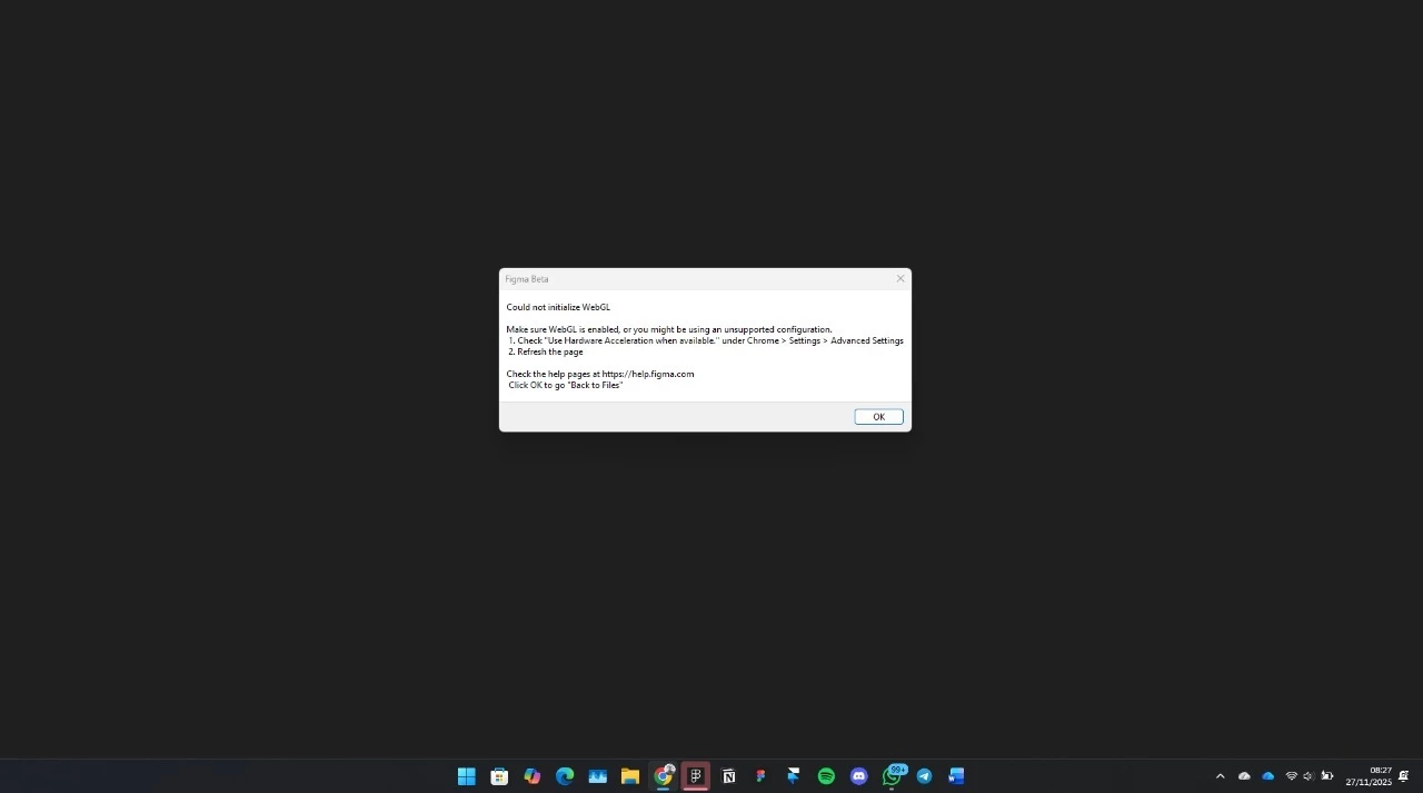

Dandi Feng
November 17, 2025
@djv Following as I have exactly the same issue.
My specs:
Lenovo Yoga
ARM64
Snapdragon(R) X Elite as well
Qualcomm Adreno X1-85 GPU
OpenCL, OpenGL, and Volkan Compatibility Pack is installed.
Attached screenshot for reference of the error.

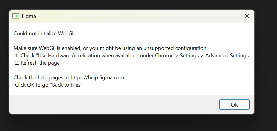

Dandi Feng
November 17, 2025
Update with more info: the screenshot is for when launching the design file.
Following the dialog box message does not resolve the issue. Still unable to launch design files in desktop app.
