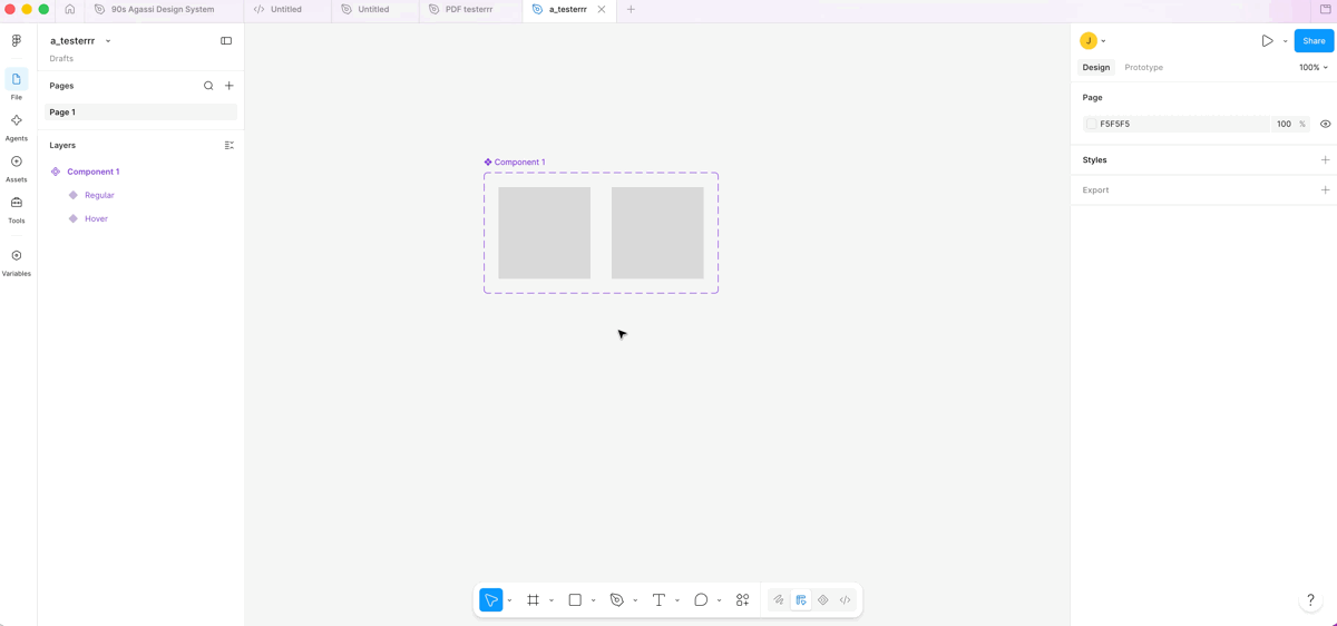

I tried to reproduce this on a fresh 2-variant component set and wasn't able to trigger the break. Here's exactly what I did:
  • Created two components and combined them as variants (single Type property, values Regular and Hover)
  • Double-clicked the "Hover" variant's layer name in the left panel — the edit field correctly showed the full Type=Hover string, fully selected
  • Committed with Enter, then double-clicked the same layer a second time to edit again
  • The property mapping held — no "invalid name" error and the Type dropdown stayed intact
  • Quick gif of my test 👇

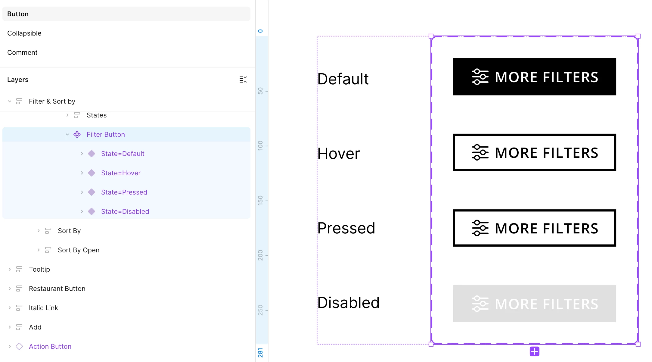

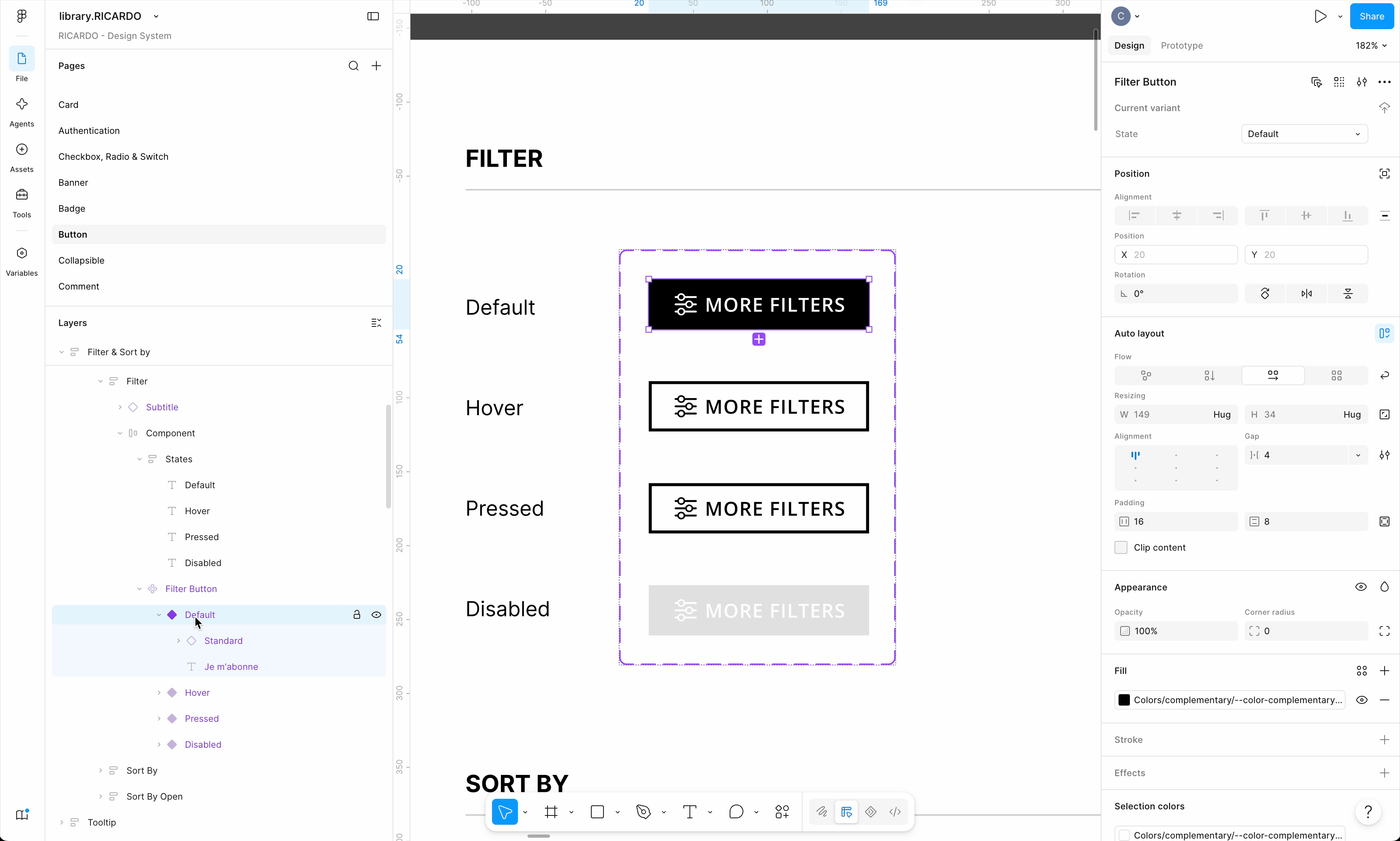

I'm sharing a video of one of my Design System Library components: the Filters button (it's like this on every component). As you can see, initially everything seems normal; the properties are there and correctly assigned. It's when I go into the component's variant a second time to make changes, when I double-click the "Hover" variant's layer name in the left panel—the edit field is incorrect and shows only "Regular" and "Default" before I type anything.
My answers :
When I double-click a variant the second time, the edit field pre-is populated with just Regular, Default before I type anything
I editing the name in the left layers panel
I only worked on Figma the desktop App, on macOS Sequoia 15.6.1 with a standard keyboard
I attached a complete video if my GIF doesn’t work well
