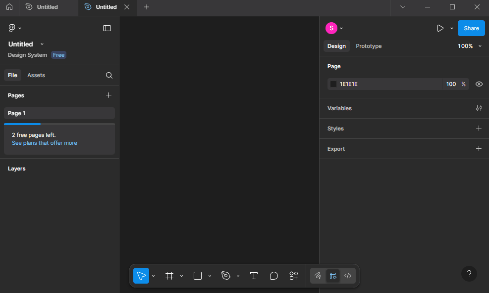

    senurich
    senurichAuthor
    Jun 3, 2025 7:19 AM UTC
    Hey, Tom.
    Using lates figma client. I’ve attached a gif with minimal repro.
    Tom Reem
    Jun 4, 2025 10:04 PM UTC
    Hey ​@senurich, appreciate you confirming and for providing the GIF — very helpful. I followed along and when I drag my cursor over width field under Dimensions, the copied rectangle width adjusted horizontally.
