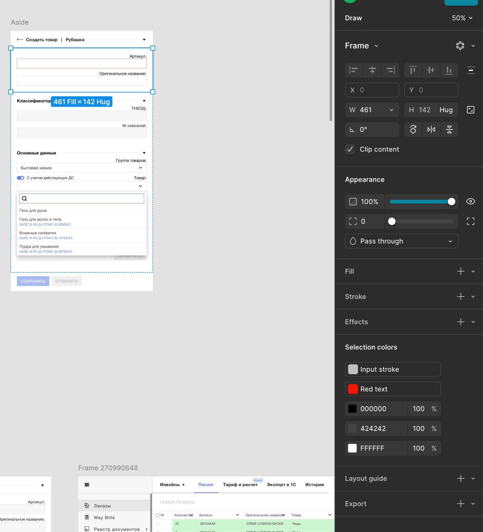

Jan 20, 2025 7:31 AM UTC
why is it hidden when I clicked ignore auto layout?
Nellya
Power Member
Jan 20, 2025 9:17 AM UTC
Probably the layer is inside a frame with a clip content
