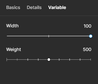

I have noticed that Figma does not display a slider for the italic axis. This only happens if the font is created with a slant axis. Is there a reason why it is not possible to select a position within the italic axis on a slider interface? According to the specs, the italic axis allows a scale interpretation.

Yes, the italic axis slider is missing. Currently, we can either use an upright (ital=0) or italic (ital=1) version of the font, but not semi-italic (ital=0.5) or other italic angles in between (ital=0.2 or ital=0.6). This should be fixed as it’s limiting the potential of variable technology. If you are giving variable axes to choose from, then it should include all the axes a font supports.

Thanks for the feedback. As I shared with the internal team, we took the approach of interpreting it as a on/off value, so the current spec for variable font italics is on or off. We keep hearing you and consider for the future improvements.

Since ital is a full-fledged variable axis, it should at least be listed in the Variable tab, even if the axis only would allow values of 0 and 1.
However, as rightly noted above, not allowing intermediate values for this axis limits the entire purpose of variable technology.

As described above, that the italic axis at the moment is even more hidden then it used to, if I remember correctly. Means the font looks broken, because if you have a variable font with 2 axis (wght, ital) you are only able to access the italic instances after changing the default cut.
