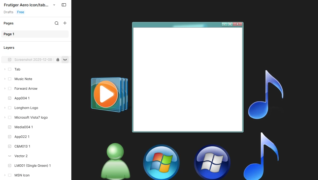

I’m experiencing a very strange and specific bug with the Layers panel visibility toggle.
What happens
  1. I click the eye icon on any layer to hide it, this works normally.
  2. After that single click, if I simply hover the mouse over other layer names (not on their eye icons), those layers also turn off one by one.
  3. The only way to stop it is to click anywhere on the screen.
  4. It feels like the “click and drag to multi-toggle visibility” feature is getting stuck in the “button still held down” state after a normal click.
It happens in every file (not file-specific).
A friend checked on his machine and does not have this issue, so it appears to be local to my setup.
When it started
I was working normally. I left the computer running for about 2 hours (no updates, no crashes, nothing unusual). When I returned, the bug was there and has stayed ever since.
What I’ve already tried
  • Restarted the PC
  • Cleared Figma cache
  • Tested in different browsers + Incognito
  • Unplugged my mouse, launchpad and XP-Pen tablet
  • Confirmed it’s not Windows ClickLock
Nothing has fixed it.
I recorded a short video that clearly shows the behavior.
Has anyone else run into something like this? Any ideas what could cause the Layers panel to get stuck in multi-toggle mode after a normal click?

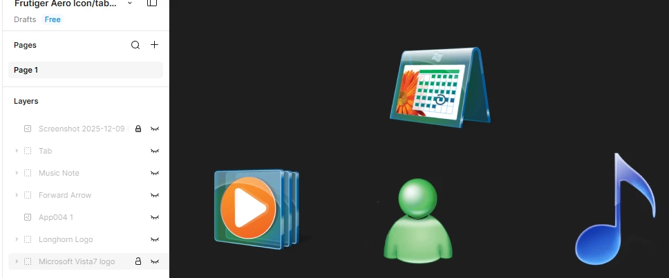

Hello,
Since this morning I'm experiencing a strange issue in Figma.
When I click the visibility (eye) icon of a layer to hide it, I release the mouse button normally. However, if I move the cursor over the visibility icons of other layers, they also toggle on/off without me holding down the mouse button.
It behaves as if Figma still thinks I'm dragging across the visibility icons, even though the mouse button has already been released.

Additional observations:
  • Hiding a layer with the keyboard shortcut (Ctrl+Shift+H) and then hovering over other layers does not trigger the bug.
  • The problem only occurs in Design/Edit mode. In Drawing mode the Layers panel behaves normally.
