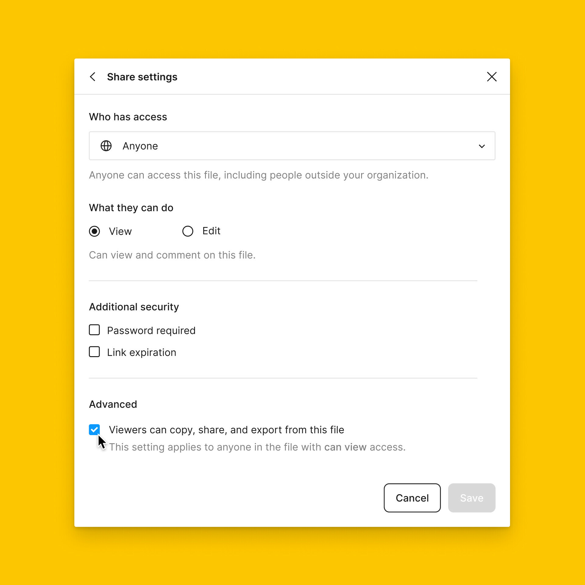

Can you also check if you’ve restricted copying and sharing on files
  1. Click the Share button from the file.
  2. Click Can view/Can edit next to the file access and permissions settings to open the Share settings.
  3. Toggle the Viewers can copy, share, and export from this file setting.
