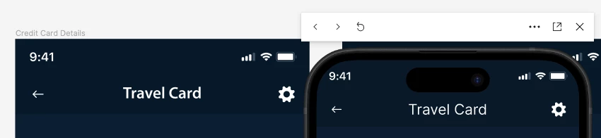

I had the same issue. But then I read one important thing in the Figma file for Advanced Prototyping by Figma you should check.
Order of actions matters. When you have multiple actions, they are run sequentially from top down. Therefore, when you have “Change to” interactions with interactive components, place that last, otherwise the component will switch before other actions are read.
So I tried it and it worked. Change the order and place the “Change to” action to the bottom and the “Set variable” actions to the top.
Screenshot 2023-08-02 at 15.26.07
But in fact, the issue comes up with locally installed fonts.
