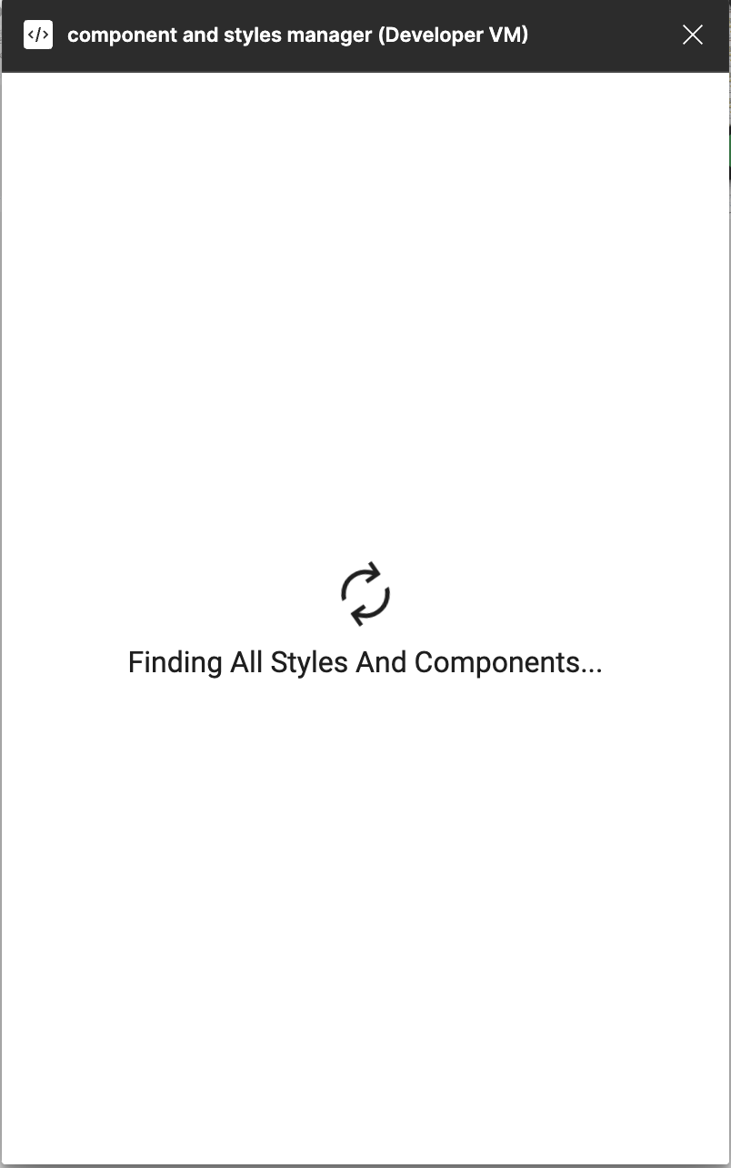

I’m want to search for text styles, colour styles, and components in the background while my UI is displaying a loading screen. AFAIK, the main ways of extracting these elements are single function calls such as figma.getLocalTextStyles() and figma.root.findAll(). Is there a way to “break up” these calls into smaller chunks?

If you make a spinner or something using CSS only (no JS), it will keep on spinning while the task is processing.

I’m already using pure css for my loading screen
Unfortunately, parts of it still freezes up when I make the expensive function calls:

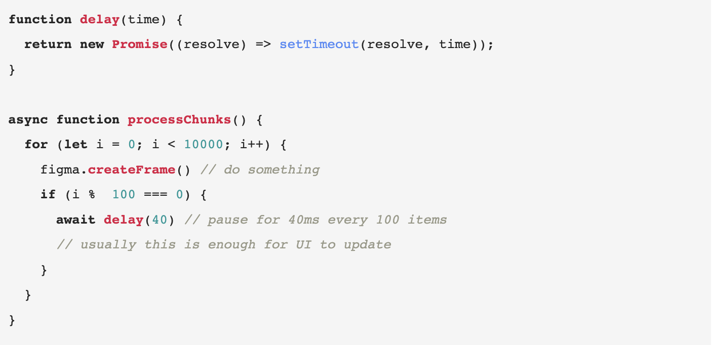

Also, in the example code that you showed in an older post,
You used a Promise to delay your async function processChunks() for every 100 iterations. Does this mean that delay() takes processChunks() off the main JS thread and allow other functions in code.ts (and even ui.html) to execute, then processChunks() takes over again when the delay “expires”?

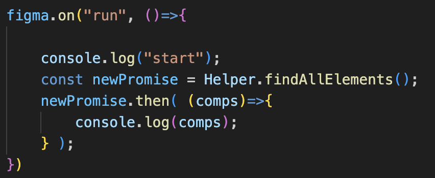

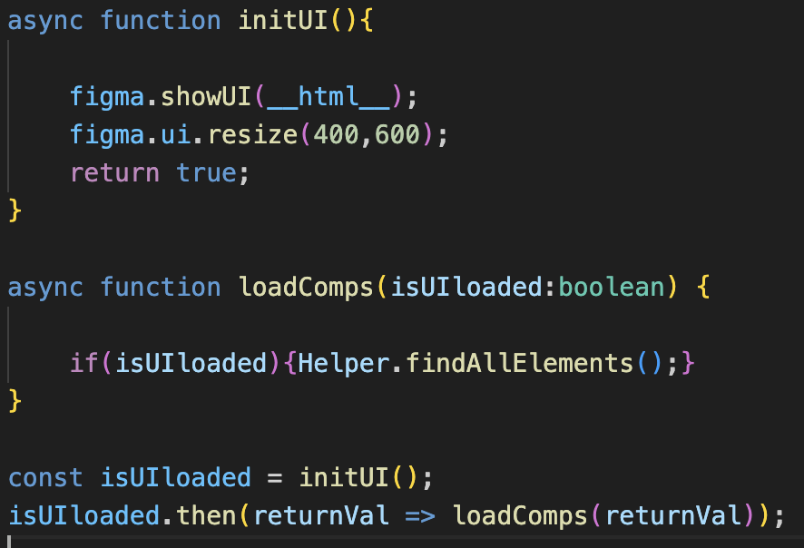

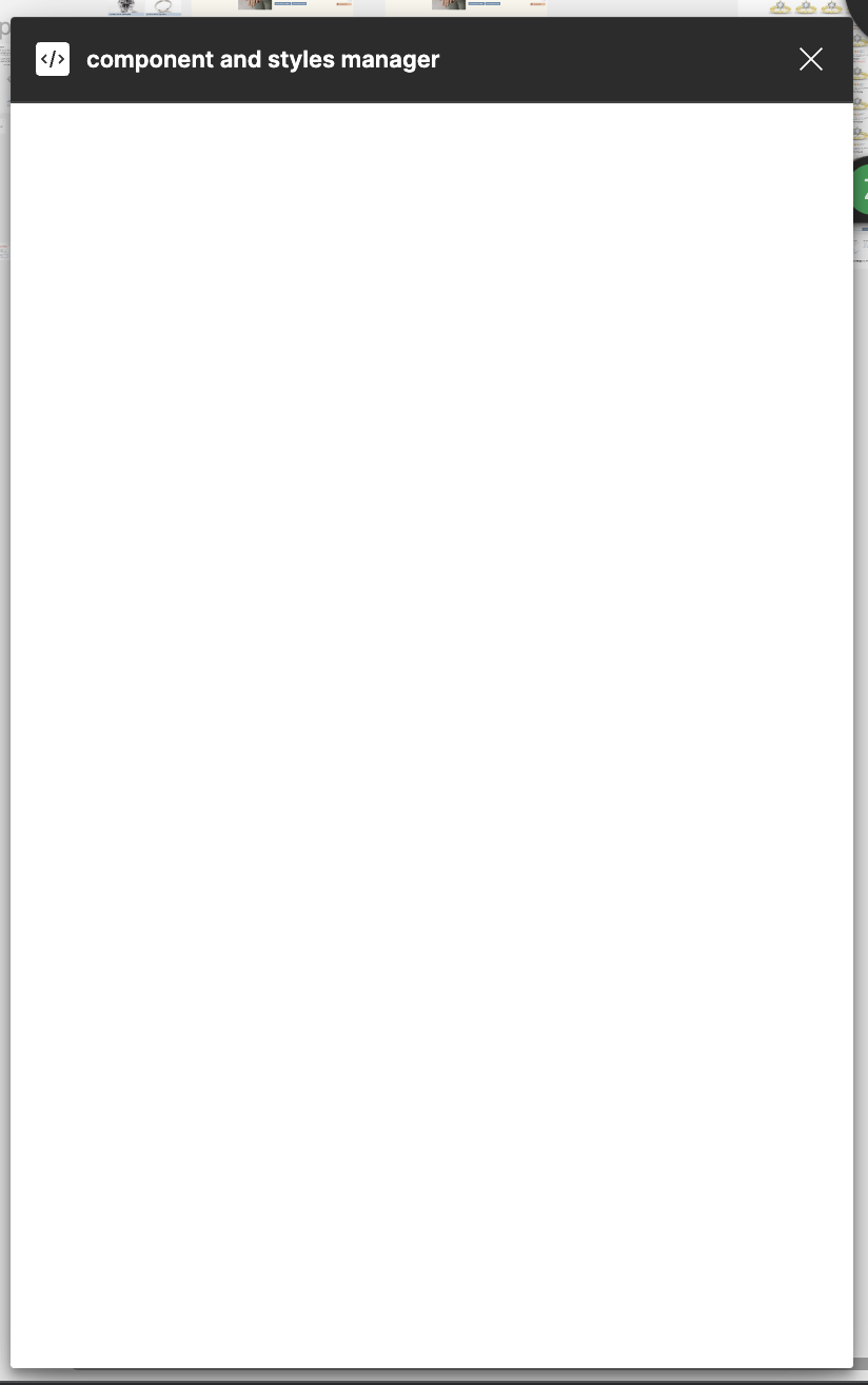

Is there a way for me to detect when ui.html has finished loading? I’ve tried 1. checking the Run event with Figma.on:
2. and I’ve also tried to chain it with as async functions:
Method 2 straight up doesn’t work, and method 1 works partially ie plugin UI window appears, but as a blank window until function is complete

From the UI, send a message to the code when the load event fires.
