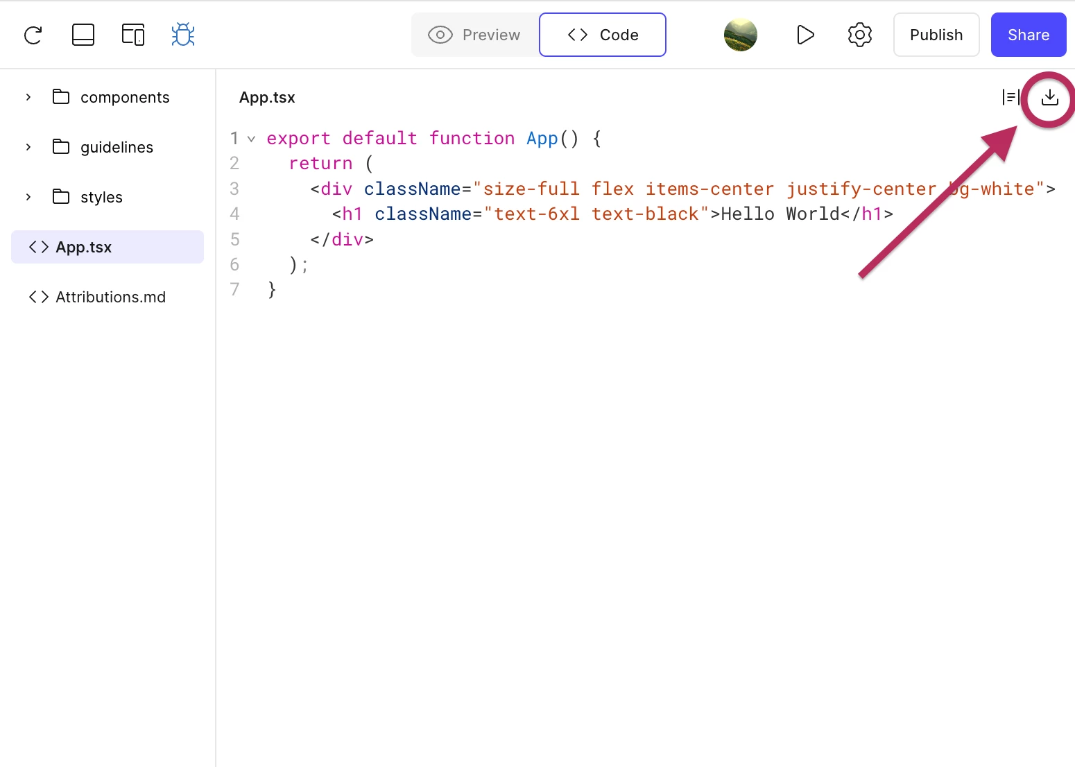

    • Saving your work: You can’t move Make files back into Figma Design right now, but you can download your code using the icon in the upper-right corner of the Code tab.
