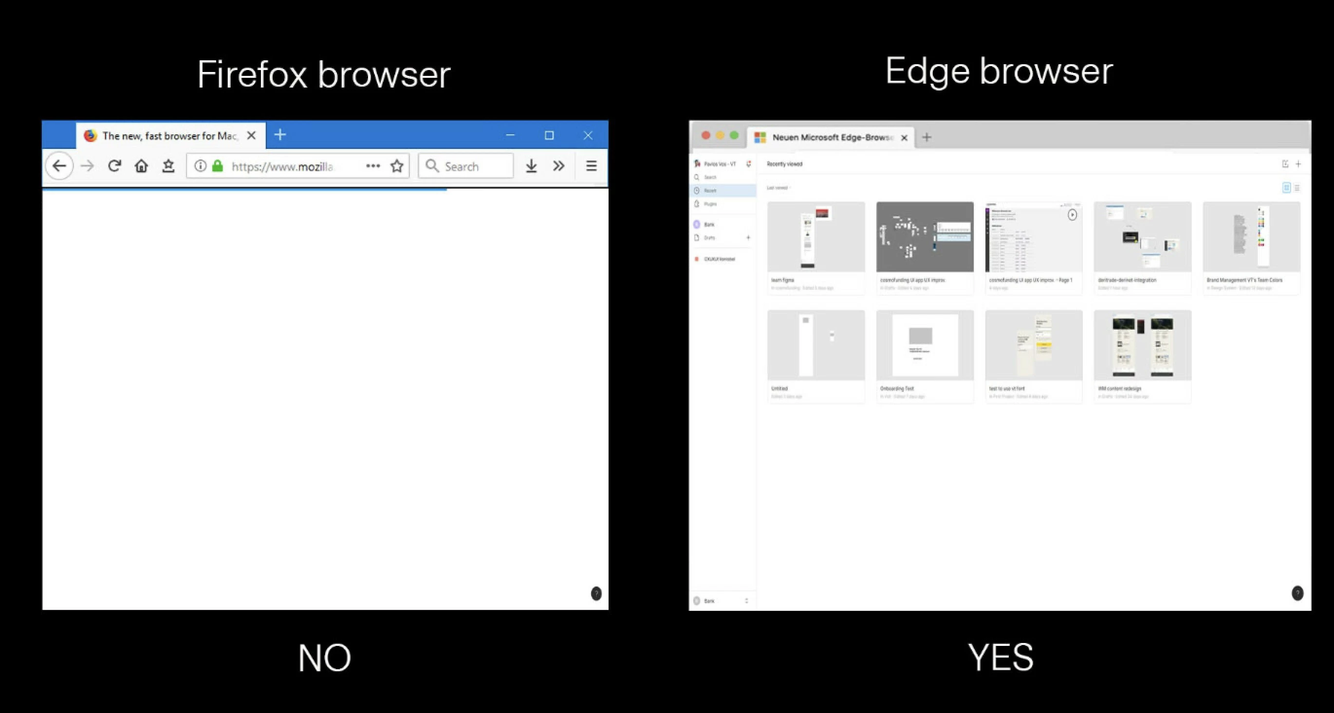

HERE IS My real Problem:
When users open Figma in Firefox (mostly their default Browser) the webhooks are blocked and figma appears broken.
This is hindering the broad adoption of figma in my organization.

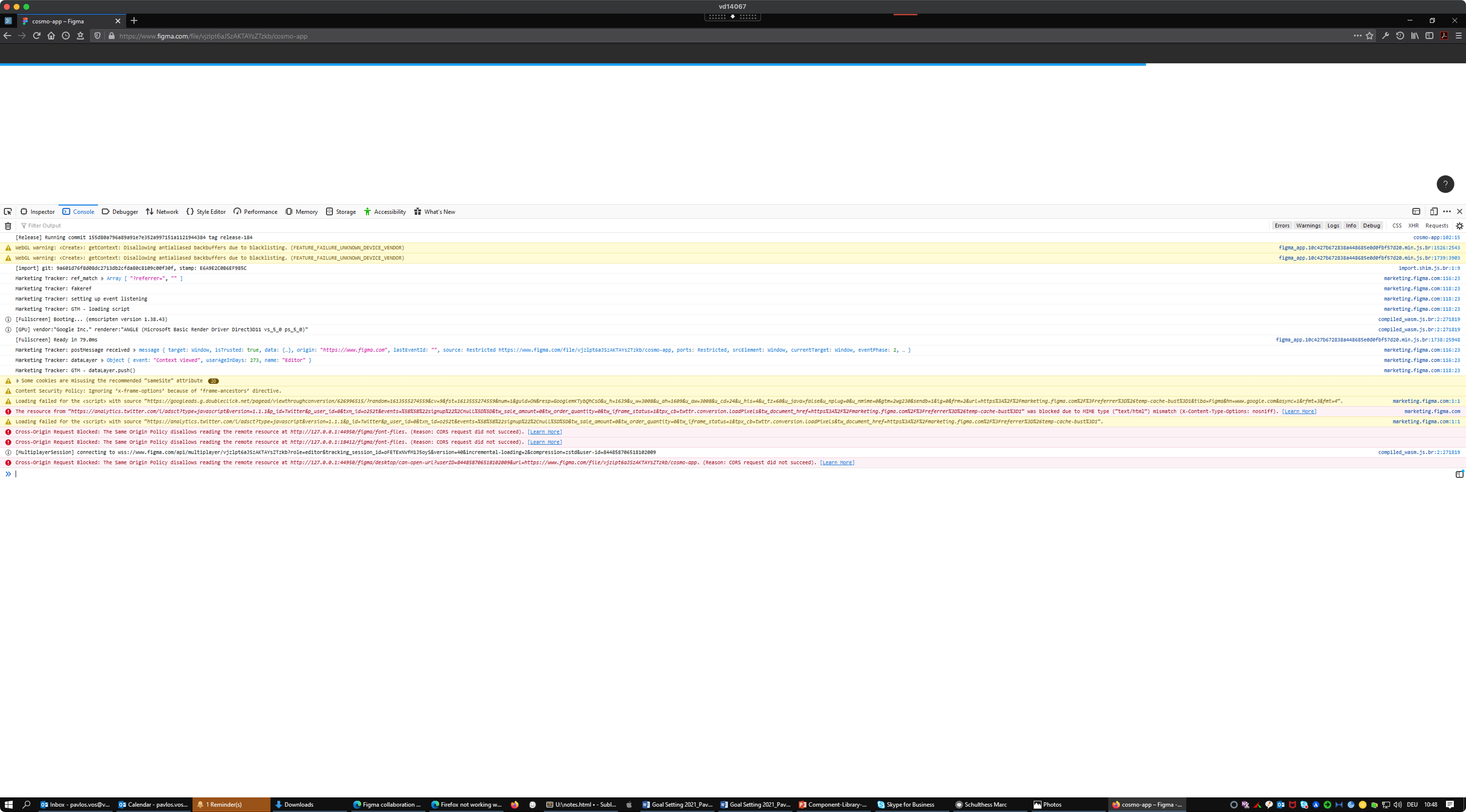

Thank you for your swift reply, i will add a screenshot.
Pavlos_Vos_VT
February 17, 2021
Pavlos_Vos_VT
February 17, 2021
Gleb
Power Member
February 17, 2021
So you issue is not related to webhooks. It looks like you have firewall or some other security software preventing access to Figma. It’s probably only blocking Firefox browser or only allowing Edge to make requests. The only way to solve this would be to talk to your IT support team at the company so they lift this limitation and allow access to Figma.

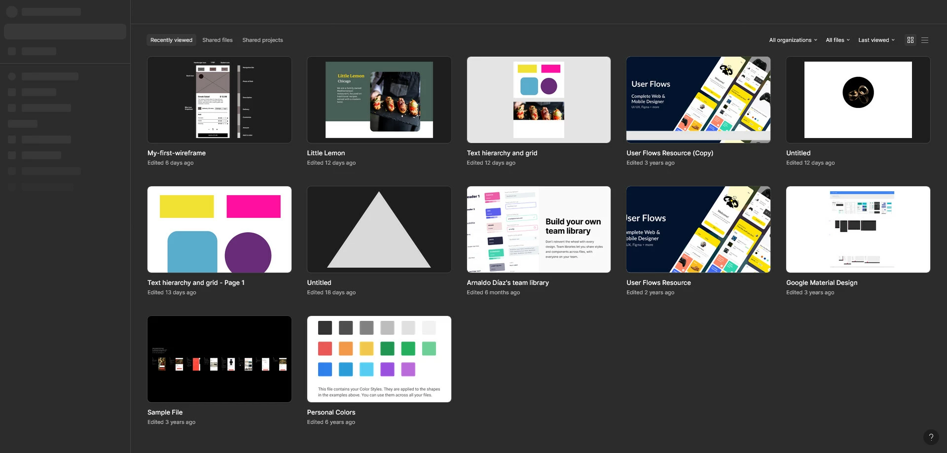

Greetings,
I have same or similar issue. When I open Figma in Firefox the UI is broken. Some components are nor being rendered properly.
Firefox:
Firefox version 126.0 (The Latest at 05/16/24)
I have no firewall other than Windows Defender.
