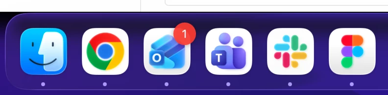

Our app icon has both a light and a dark version, and macOS switches between them based on your Mac's overall Appearance setting (System Settings > Appearance), not anything inside Figma itself. Set to Dark, you'll see our darker icon; set to Light, you'll see the newer, lighter version from our recent icon refresh, which is the intended design rather than a bug.
That's also why the in-app Theme setting didn't change anything for @Denis_b. Figma's Theme preference only affects the look of the Figma interface itself. Your dock icon follows your system-wide Appearance setting instead, separately from that.
@Jon Taylor, to your point on Apple's standards. We do already provide both light and dark variants, so that part's in place. The gap is that macOS doesn't let you select one independent of your system-wide setting; that's a platform-level constraint for every app, not something we can toggle on our end alone.
@Jarek Gąska, to directly answer your question: right now there's no supported way to get just Figma's dark icon while keeping the rest of your Mac on Light mode. A few options if you want to explore anyway:
- Switch your whole Mac to Dark mode (System Settings > Appearance) to get Figma's dark variant along with everything else that supports it.
- If you'd rather stay in Light mode, macOS Tahoe's Icon & widget style setting (same Appearance panel) has a Dark option that forces a darker treatment across your compatible app icons. But that applies system-wide, not just to Figma.
- The manual Finder step-around I shared above still works if you only want Figma's icon changed, though it can reset with app updates.
