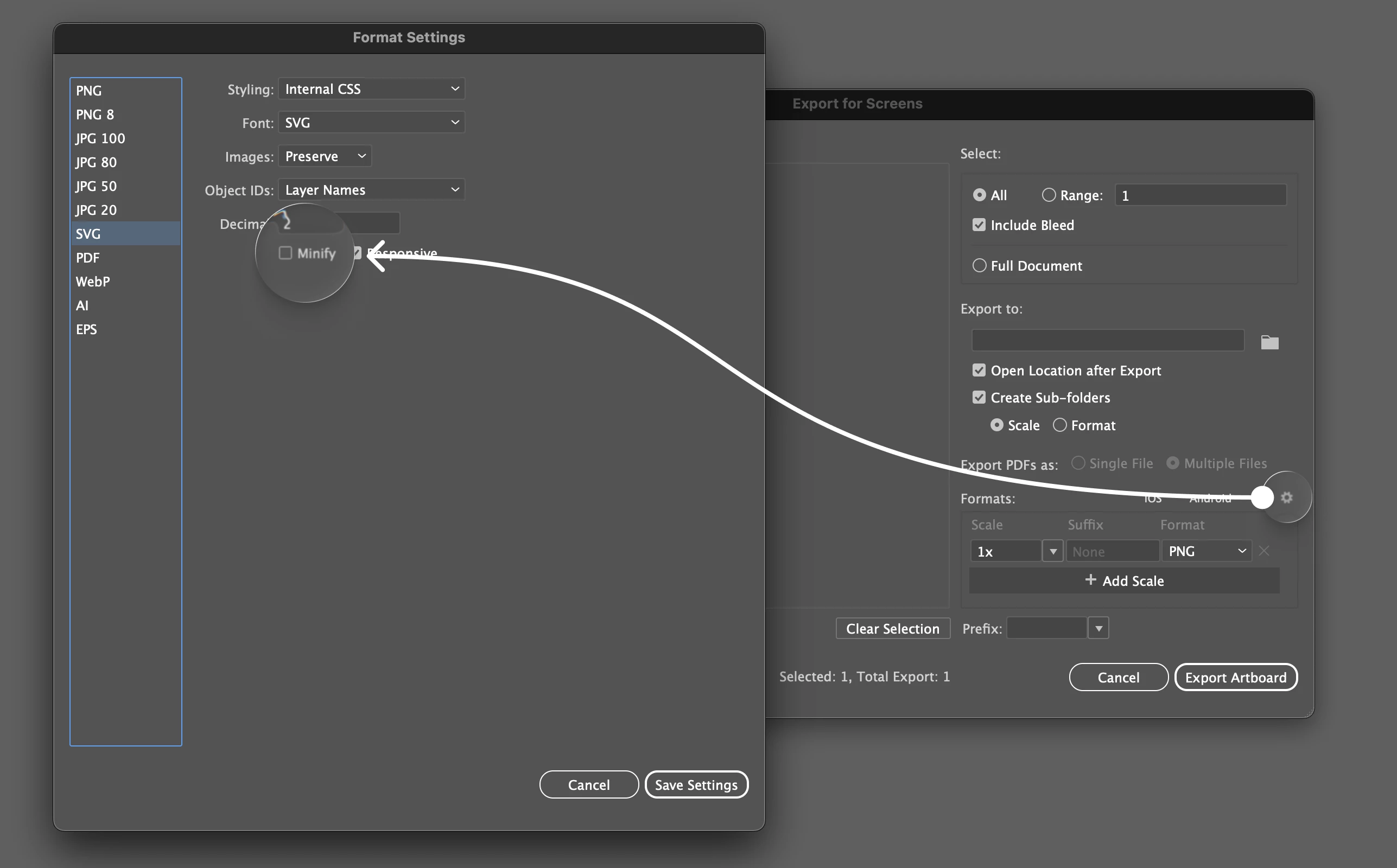

Best answer by djv
Hey All, thank you for your patience while our team worked towards a solution with Adobe!
Adobe identified the root cause and now have a fix in place. The issue stems from a code change introduced in version 29.8.x and is not related to the recent SVG settings change. They also confirmed the exact repro: the issue occurs when the SVG “Minify” option is enabled.
They will be disabling the feature flag associated with this code change and will let us know once it’s complete. After the flag is turned off, you will need to restart the application and Copy/Paste with the Include SVG setting enabled to ensure it will work as expected.
You can find the setting under File > Export for Screens, and hit the little settings icon in that Dialog...go down to SVG and uncheck minify (until the fix has been fully rolled out by Adobe).

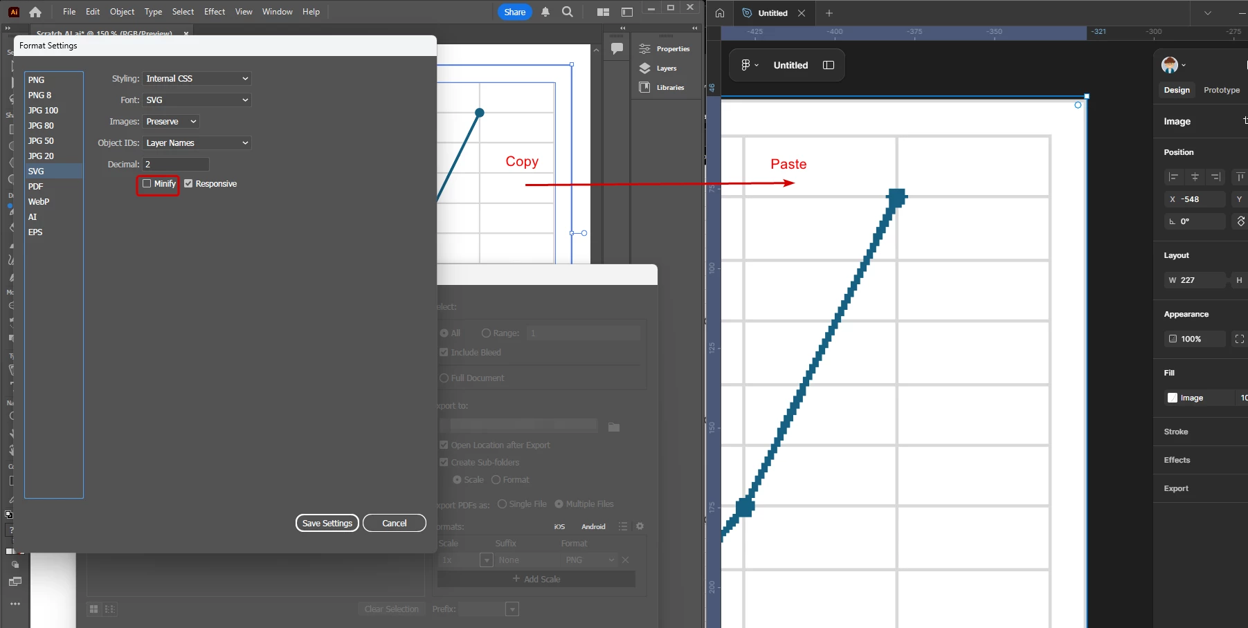

Pasting vectors did not work for me as of at least 10 months ago.
djv
September 23, 2025
Thanks for following up ​@macamrstudios and ​@Brian_Olson!
I flagged this to the team to investigate, and they discovered that this is a new issue with Illustrator 29.8.1
Our fix in August was for the previous version of Illustrator, but now, it seems that copy/paste is broken entirely, even with the checkbox on for include svg.
As a new temporary solution, if you want to get contents out from illustrator and into Figma, you will need to export as SVG and then drag the SVG into Figma.

Hey ​@spds, ​@macamrstudios, and ​@Brian_Olson,
Thanks again for your patience and understanding while our team tries to get this fixed!
We are now working together with Adobe to try and pinpoint the issue, and Adobe is wondering if we could get the following details from any of you who are currently experiencing the issue:
  1. Operating system and version
  2. Figma version
  3. Adobe illustrator version
With these details, we’ll hopefully be able to successfully repro to see what ultimately caused this issue.
Thank you for working on this! :)
1. OS and Version
Edition    Windows 11 Enterprise
Version    24H2
Installed on    ‎11/‎19/‎2024
OS build    26100.6584
Experience    Windows Feature Experience Pack 1000.26100.234.0
2. Figma Version
Figma Desktop App version 125.8.8
3. Adobe Illustrator Version
29.8.1 (64-bit)
