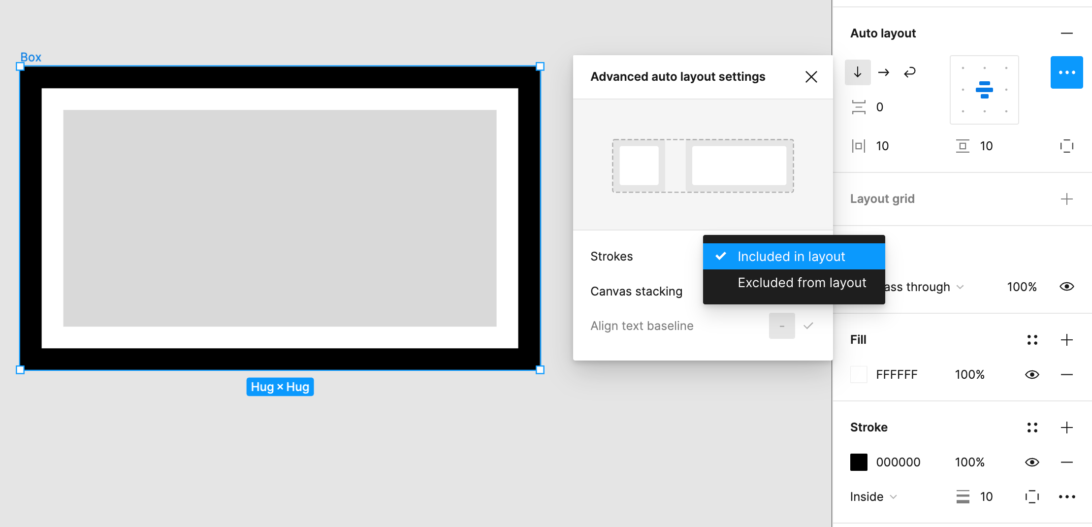

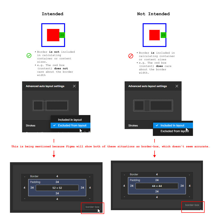

Adding, for example, 1px borders does not increase the size of the frame.
It makes designing websites where “box-sizing: border-box” just not accurate with how browser compute the width and height.
How do you go around this behavior ?
for me, I add extra 1px padding around the frame (I also have to be using auto-layout).
Best answer by Daniel_Cullinan
It works in Figma, you just need to choose 'Strokes: Included in layout" from the Auto layout options:

I’m sure that borders aren’t included intentionally as the mental taxing of building on a 8px grid gets a lot more time-consuming and complicated when you factor border and alter padding when building the design system
Where it should change imo would be the inspect panel. Removing border-box and altering the padding of auto-layout blocks with a border could happen there.
