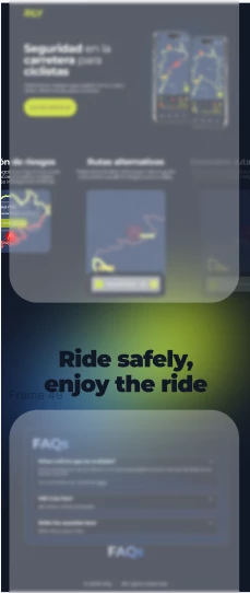

    Alina_Khazanova
    Sep 7, 2023 11:43 AM UTC
    I have a lot of trouble showing floating elements like tooltips / dropdowns because of this. Dropdown menus are possible to “hack” with tricks like “last on top” in auto layout.
    But tooltips that must appear above everything, especially in situations when they’re inside a container that must be clipped, for example, is a nightmare.
    We need a Z index option, or at least an option to “display above everything”
    Example of tooltip issues attached
