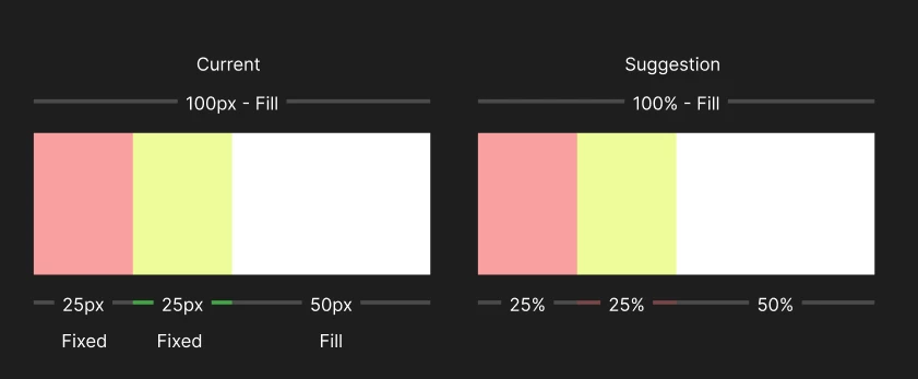

Use percentages for heights, widths, paddings, gutters in auto layout
  • December 9, 2022
  • 103 replies
  • 9606 views
This makes it easier to use components in designs for different screen sizes. And then you don’t have to calculate every time what 40% or 60% of the width is.
This also makes it easier to design scalable applications that grow with the width of the screen.
